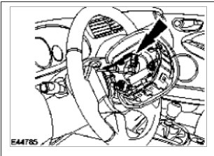

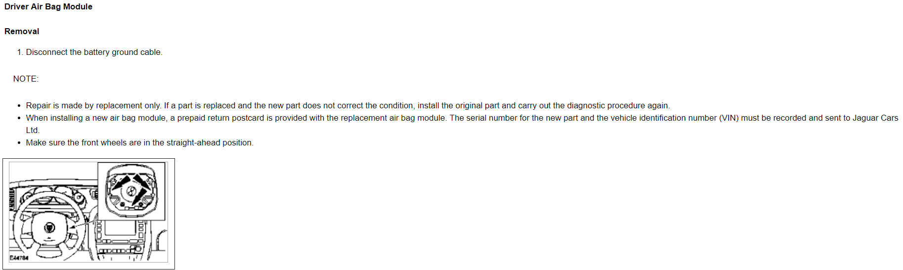

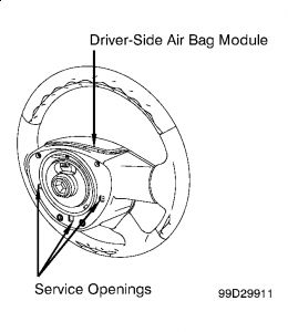

I am trying to remove the horn and airbag assembly. I am told there are two screws that when removed, the assembly will come right out. I can't locate the screws?
Mar 18, 2010 at 3:25 AM
DAVE H
  • 13,384 POSTS
Hello, Here is a guide to help you see what you are in for when doing the job. https://www.2carpros.com/articles/air-bag-removal-steering-wheel
https://images.2carpros.com/forum/automotive_pictures/266999_jag_92.jpg

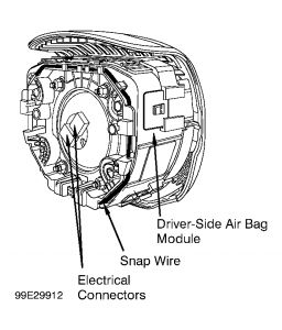

Fig. 4: Identifying Driver-side Air Bag Module Snap Wire
https://images.2carpros.com/forum/automotive_pictures/266999_jag2_7.jpg
Here are more diagrams to how you how to do the job. Check out the diagrams (Below) Please let us know if you need anything else to get the problem fixed. Cheers
