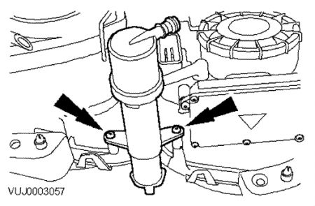

I am working on headlights and need a diagram of how they should look. Looks to me like there may be a clip missing on the housing.
Aug 15, 2010 at 3:45 AM
  • 75,988 POSTS
Service and Repair Removal All vehicles Remove the front bumper cover.
https://images.2carpros.com/forum/automotive_pictures/12900_h1_17.jpg

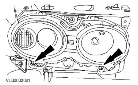

Remove the headlamp assembly retaining bolts.
https://images.2carpros.com/forum/automotive_pictures/12900_h2_16.jpg

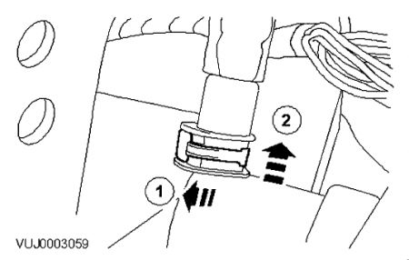

Detach the headlamp assembly. Vehicles with headlamp washers
https://images.2carpros.com/forum/automotive_pictures/12900_h3_5.jpg

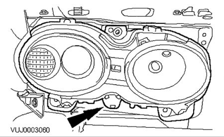

Disconnect the headlamp washer hose. *Release the headlamp washer hose retaining clip. *Disconnect the headlamp washer hose. All vehicles
https://images.2carpros.com/forum/automotive_pictures/12900_h4_5.jpg

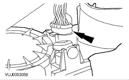

Remove the headlamp assembly. Disconnect the electrical connector. Vehicles with headlamp washers
https://images.2carpros.com/forum/automotive_pictures/12900_h5_3.jpg
Remove the headlamp washer motor. Installation: To install, reverse the removal procedure. Check the headlamp adjustment. See: Adjustments https://www.2carpros.com/kpages/auto_repair_manuals_alldata.htm
