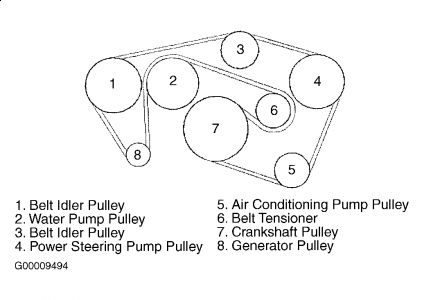

what is the routing for the serpentine belt on a 2.5 V6 x-type 2001

https://images.2carpros.com/forum/automotive_pictures/266999_jag_63.jpg
