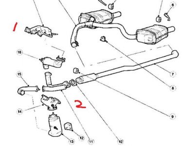

how many 02sensors are there on the 3ltr petrol v6 engine.my fault code is poo37 and i need to replace sensor2 bank 1.it is after cat.converter.can you tell me where it is and which side is bank 1on the car?im getting info that there is 4 02sensors 2before the cat.and2 after,are the two after the same type?

Bank 1 is Right hand side (looking from drivers seat) Bank 2 is left side HO2 Sensor Downstream 1/2On bank 1 exhaust. HO2 Sensor Downstream 2/2On bank 2 exhaust. HO2 Sensor Upstream 1/1On bank 1 exhaust. HO2 Sensor Upstream 2/1On bank 2 exhaust.
https://images.2carpros.com/forum/automotive_pictures/266999_jag_70.jpg
