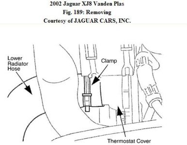

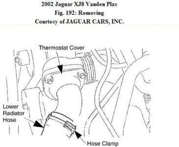

I want to change the thermostat but I don't know where it is. Where can I find this info? Can you describe where it would be located?
Apr 13, 2009 at 3:43 PM
BLUELIGHTNIN6
  • 16,542 POSTS
Follow lower radiator hose to engine. Thermostat is in thermostat housing at engine after removing lower radiator hose. Non-Supercharged
https://images.2carpros.com/forum/automotive_pictures/261618_Noname_446.jpg
Supercharged
https://images.2carpros.com/forum/automotive_pictures/261618_Noname2_122.jpg
Let me know if you need replacement instructions. List if engine is supercharged or non-supercharged if so.. Thanks for using 2CarPros.com!
