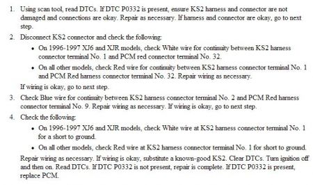

Where is the "knock sensor 2 circuit low bank 2" sensor located? I got a code P0332, and i need to diagnose the problem. Should I replace teh sensor, or how do I diagnose the problem?

Sensor 2 is the rear knock sensor. Located at left rear of engine block, usually near the manifold. This code may be caused by sensor being loose, a short or open circuit in ground wire, or the sensor itself may be faulty. Diagnostic procedures are below.
https://images.2carpros.com/forum/automotive_pictures/261618_Noname_212.jpg
