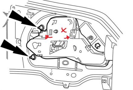

How to remove the passenger side tail lamp bulb its the one on the top that controls park & brake light i squeezed the clamps and tried to pull out but to no avail. do i need to remove the whole black casing as one part to get to all bulbs. Help with this matter will be highly appreciated.

the cover marked with X unclip at arrows and comes off to replace bulbs
https://images.2carpros.com/forum/automotive_pictures/266999_jag_101.jpg

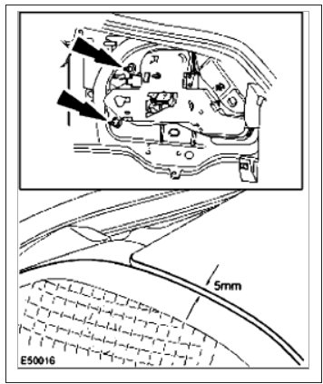

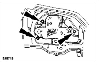

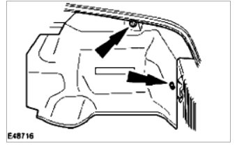

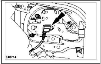

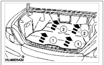

Here is a guide that can help as well https://www.2carpros.com/articles/no-tail-lights-exterior-running-lights-tail-lights-out Check out the diagrams (Below) Please let us know if you need anything else to get the problem fixed. Cheers
