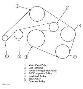

What is the belt path on the surpentine drive belt?
