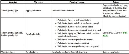

please explain your fault ?
https://images.2carpros.com/forum/automotive_pictures/266999_jag_80.jpg
