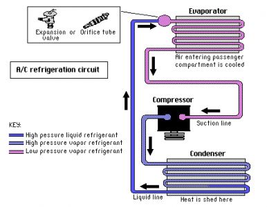

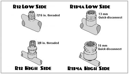

can not find the dang low side charging valve
Jun 7, 2010 at 3:31 PM
Experienced Mechanic
75,988 POSTS
The low side is 13mm fitting is on the piping between the compressor and evaporator sorry no pic for exact location
Jun 7, 2010 at 3:49 PM
75,988 POSTS
Its on the compressor
