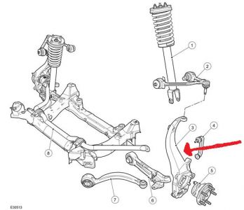

how does one goe about removeing the lower ball joint
Oct 17, 2009 at 7:01 AM
DAVE H
  • 13,384 POSTS
The ball joint is part of the steering knuckle and cannot be replaced seperately !!
https://images.2carpros.com/forum/automotive_pictures/266999_jag_8.jpg
