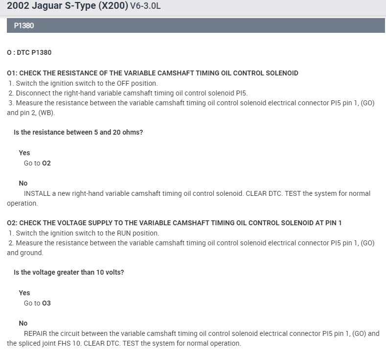

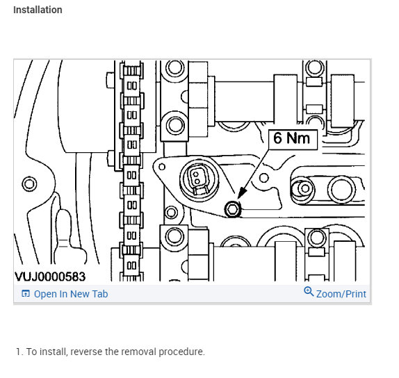

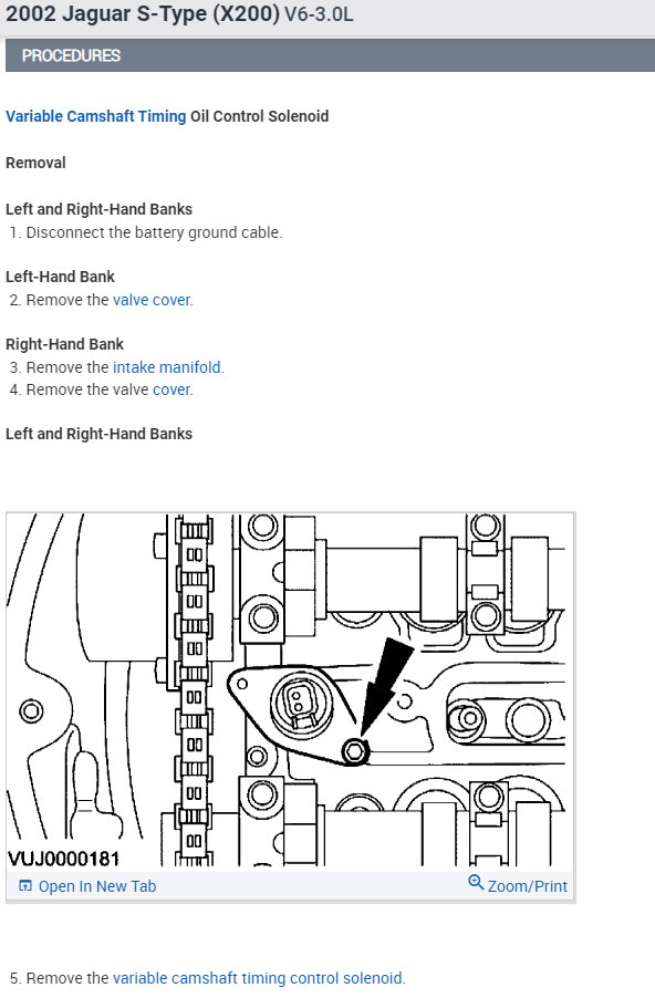

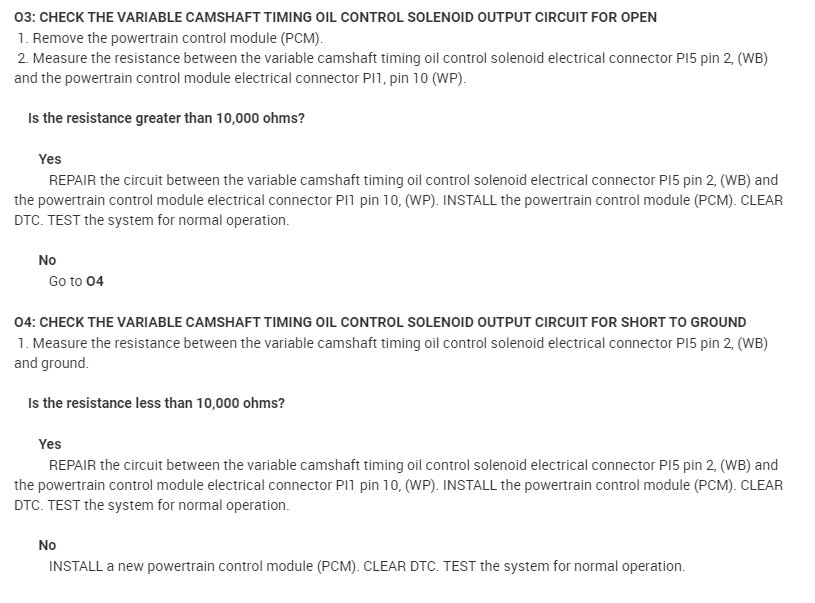

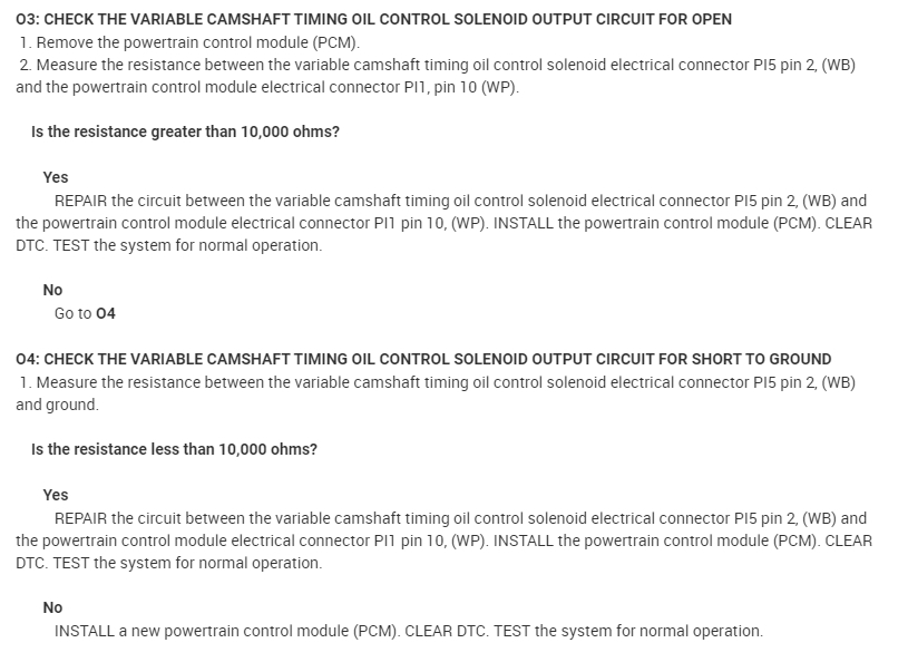

The code P1380 gets triggered when there is an issue detected with the camshaft solenoid. It could be due to a bad solenoid or even an issue with the PCM.
I have attached the troubleshooting steps for the code P1380 below.
Go thru those steps as that can help you determine the issue.
