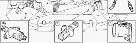

If it's only during cold starts, the ECT(engine coolant temp)sensor, it acts like the choke on EFI engines. On the 4.0L V8 AJ-V8 engine, it is located at the front of the engine, near the upper radiator hose connection.

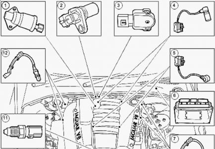

Thank you for your timely reply. Would it be possible to get a diagram of the location of the ECT Sensor?

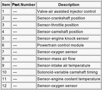

#11 in the diagram:
https://images.2carpros.com/forum/automotive_pictures/62217_sensors40a_1.jpg
https://images.2carpros.com/forum/automotive_pictures/62217_sensorsb_1.jpg
https://images.2carpros.com/forum/automotive_pictures/62217_sensorsc_1.jpg
