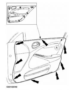

Right side passenger door window fell into the door as I was trying to power the window up.
Bought the window regulartor from the jaguar dealer after explaining what had happened.
Removed the door Handle Bezel
Removed the trim panel retaing screw cover and screws.
Need to know how to remove the door panel.
Does it pull out? Is there a retaining pin?

Hello .. thanks for the donation .. much appreciated The trim panel is clipped into place, get a trim panel tool (or flat screwdriver) behind panel at arrowed points and pull outwards .. (you will damage fifty percent at least, of panel clips) so it is a good idea to buy more panel clips ! Front Door Trim Panel Removal Remove the front door interior handle bezel. Remove the front door trim panel retaining screw cover. Remove the front door trim panel retaining screws. Fig. 16: Removing Front Door Trim Panel Retaining Screws
https://images.2carpros.com/forum/automotive_pictures/266999_jag_103.jpg
Detach the front door trim panel. To aid removal release clip A by lowering the glass and pressing the panel inward. Fig. 17: Detaching Front Door Trim Panel
https://images.2carpros.com/forum/automotive_pictures/266999_jag2_9.jpg
Disconnect the front door trim panel harness electrical connector. Remove the front door trim panel. Disconnect the driver door module electrical connector. Hope this helps
