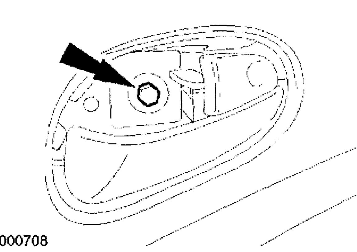

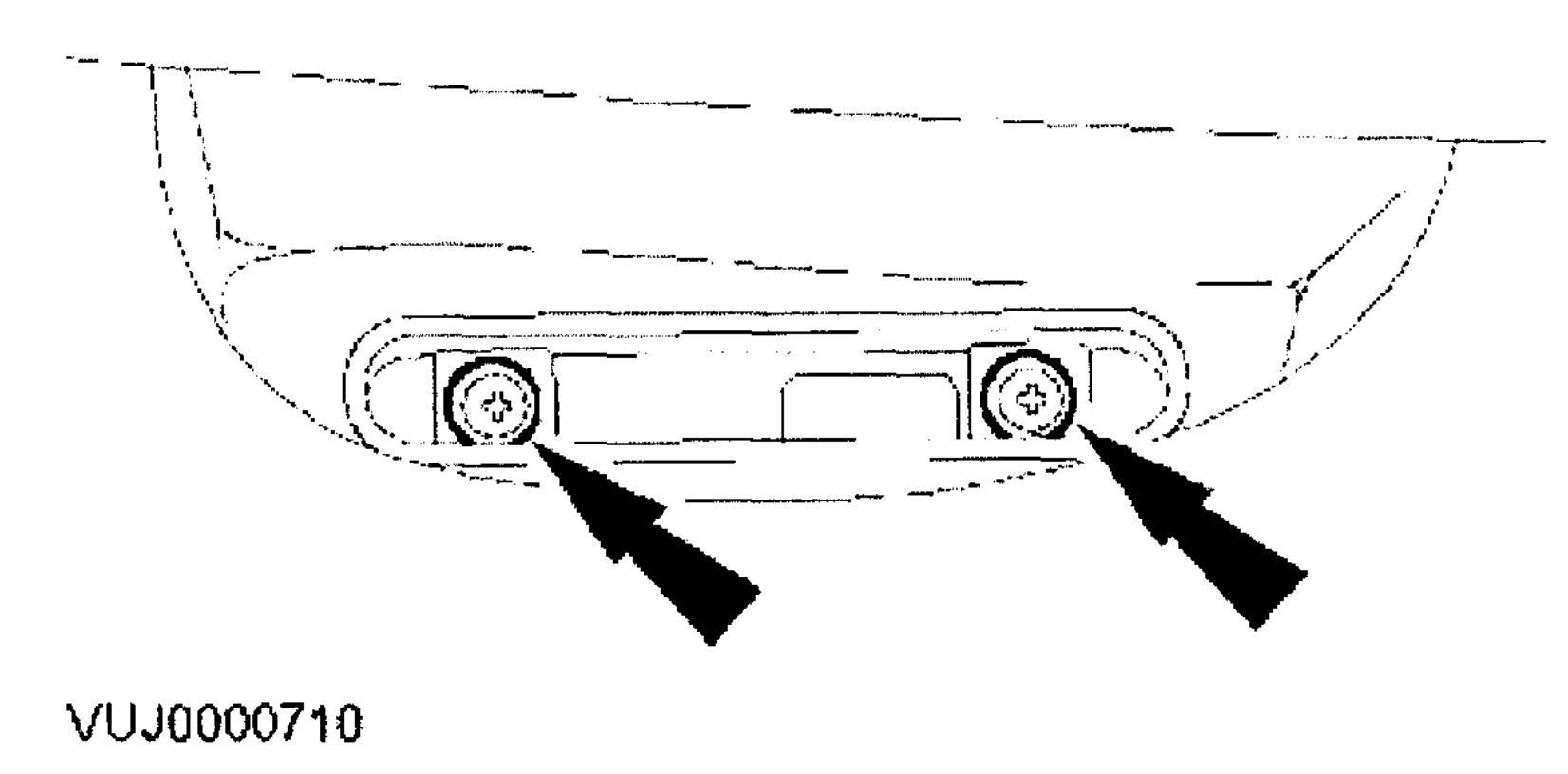

How to remove inside door panel
May 25, 2009 at 1:15 PM
DAVE H
  • 13,384 POSTS

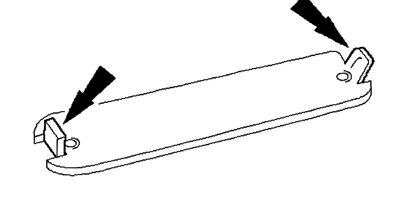

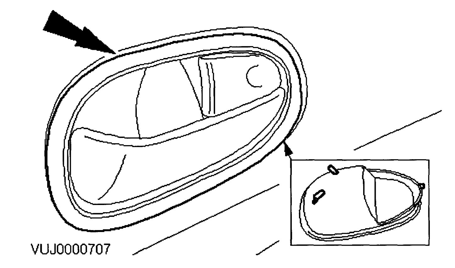

1. Remove the door latch bezel.

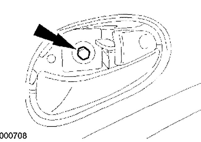

2. Remove the door trim panel retaining bolt.
3. Remove the door pull handle screw cover.
4. Remove the door pull handle retaining screws.

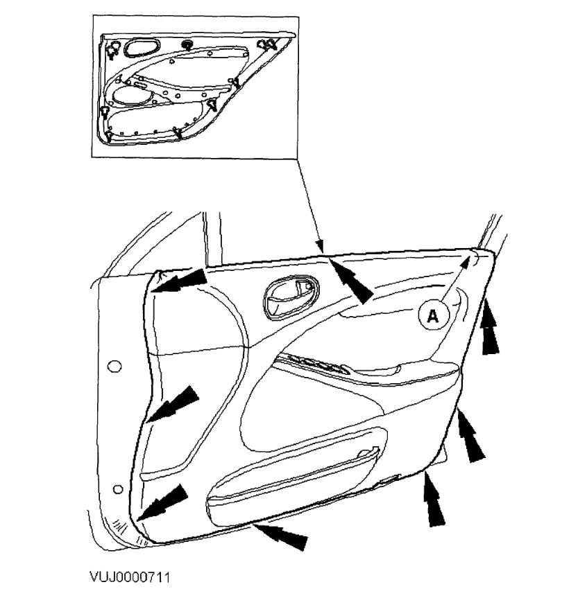

5. Detach the interior door trim panel.
- To aid removal release clip A by lowering glass and pressing case inwards.

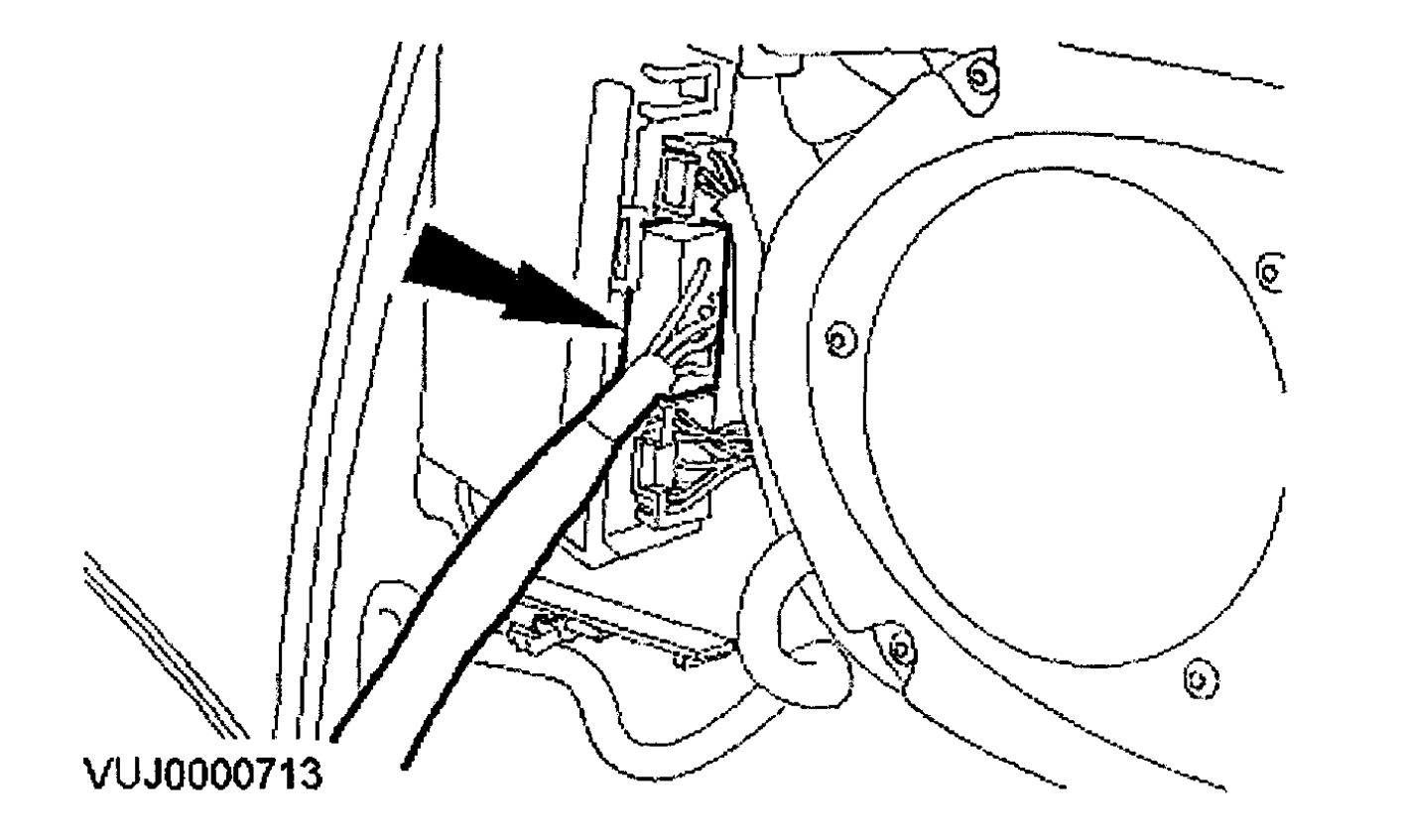

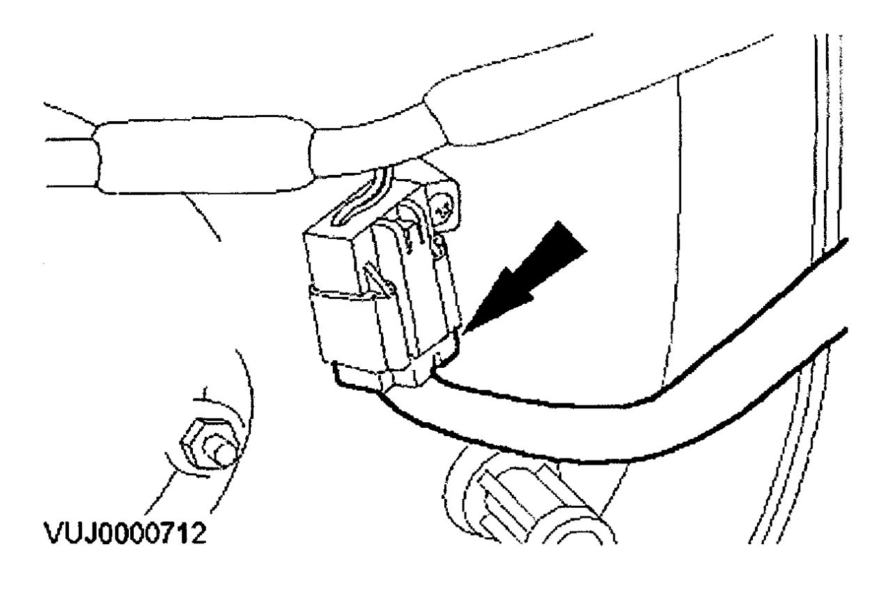

6. Disconnect the door trim harness electrical connector.
7. Remove the door trim.
- Disconnect the driver door module electrical connector.
See diagrams below
