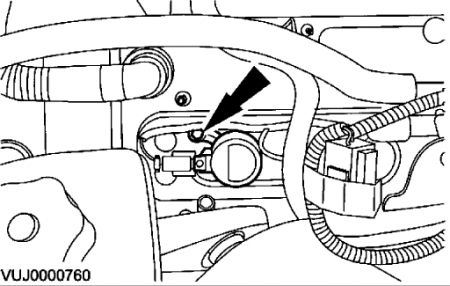

how to replace ingintion coil
Sep 9, 2010 at 9:14 PM
  • 75,992 POSTS

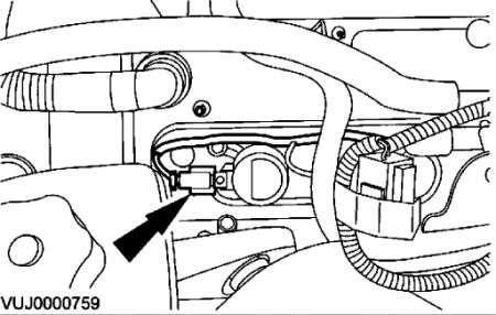

Service and Repair Ignition Coil-On-Plug Removal Left and Right-Hand Bank Disconnect the battery ground cable.
https://images.2carpros.com/forum/automotive_pictures/12900_i1_4.jpg
Remove the engine cover. Left-Hand Bank Remove the evaporative emission canister purge valve. Remove the oil level indicator.
https://images.2carpros.com/forum/automotive_pictures/12900_i2_4.jpg

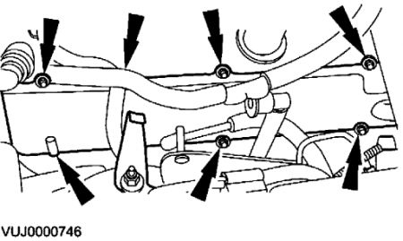

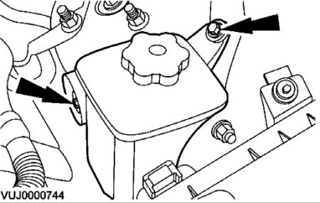

Detach the power assisted steering fluid reservoir.
https://images.2carpros.com/forum/automotive_pictures/12900_i3_3.jpg

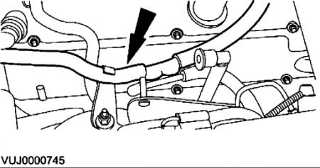

Unclip the engine breather hose. Right-Hand Bank Remove the air intake tube. Left and Right-Hand Bank
https://images.2carpros.com/forum/automotive_pictures/12900_i4_1.jpg

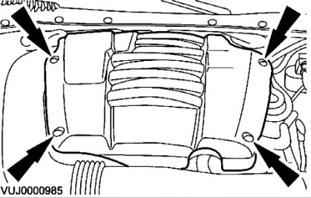

NOTE: Left-hand bank shown, right-hand similar. Remove the ignition coil cover.
https://images.2carpros.com/forum/automotive_pictures/12900_i5_1.jpg
Disconnect the ignition coil electrical connector.
https://images.2carpros.com/forum/automotive_pictures/12900_i6_1.jpg

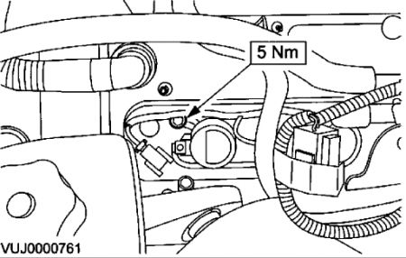

Remove the ignition coil. Installation
https://images.2carpros.com/forum/automotive_pictures/12900_i7_1.jpg
To install, reverse the removal procedure. https://www.2carpros.com/kpages/auto_repair_manuals_alldata.htm
