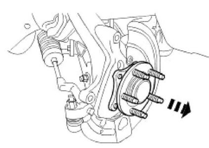

im tring 2 replace my front hub bearing assembly i removed the for bolts but it still wont come loose what 2do

Wheel Bearing and Wheel Hub Removal Remove the brake disc. Detach the anti-lock brake (ABS) sensor. Remove and discard the retaining clip. Detach the ABS sensor. Remove and discard the O-ring seal. Remove the wheel hub and bearing retaining bolts. Remove the wheel hub and bearing. Fig. 51: Removing Wheel Hub And Bearing Courtesy of JAGUAR CARS, INC.
https://www.2carpros.com/forum/automotive_pictures/266999_jag_3.jpg
Installation NOTE:Prior to applying sealer, clean the ABS sensor sealing surface and the ABS sensor aperture sealing surface. NOTE:Install a new O-ring seal. NOTE:Apply a 2.5mm bead of LOCTITE Ultra Blue 587 Silicone (RTV) sealer to the ABS sensor sealing surface. NOTE:Install a new ABS sensor retaining clip. To install, reverse the removal procedure. Tighten to 90 N.m.
