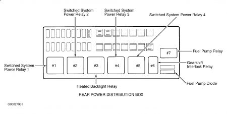

I am having problems with the fuel pump, would like to know if it has a fuel pump relay and how can i locate or identify it in the fuse compartment box? Are there any other tip to solving the problem. Fuel pump will not run. Was running when I took car down to replace coolant reservoir, thermostat and housing, and crossover pipe. Put every thing back together and fuel pump will not start. Cannot isolate fuel pump relay because the relays are not included in the diagram in the manual

Here is the location for the fuel pump relay with a guide to help you test it https://www.2carpros.com/articles/how-to-check-an-electrical-relay-and-wiring-control-circuit Check out the diagrams (Below). Please let us know if you need anything else to get the problem fixed.
https://images.2carpros.com/forum/automotive_pictures/198357_Graphic_302.jpg
