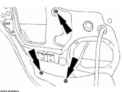

The rear window regulator is broken.I removed the doorpanel and lowered the window 3/4 of the way to access the plastic nut that holds the regulator to the window. Is there a special tool to remove this nut or do I need to just force a screw driver in tighter? Jim h

Rear Door Window Regulator and Motor
Removal
Remove the rear door window glass. For additional information, refer to REAR DOOR WINDOW GLASS.
Detach the rear door window regulator and motor.
Fig. 27: Detaching Rear Door Window Regulator And Motor
https://www.2carpros.com/forum/automotive_pictures/266999_jag_81.jpg
Remove the rear door window regulator and motor.
Disconnect the rear door window regulator and motor electrical connector.
Installation
To install, reverse the removal procedure.
Tighten to 6 N.m.
