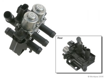

Since having a new engine and the bottom hose coming off on the test run. The heater will only blow cold and as you can imagine not good thing at this time of year. Cheers

Check coolant level is good. Replace thermostat !.

Just replace
https://www.2carpros.com/forum/automotive_pictures/484920_heater_control_valve_1.jpg
heater control valve. It's located on the copilot side near the front headlight.
