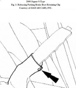

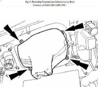

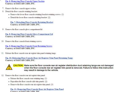

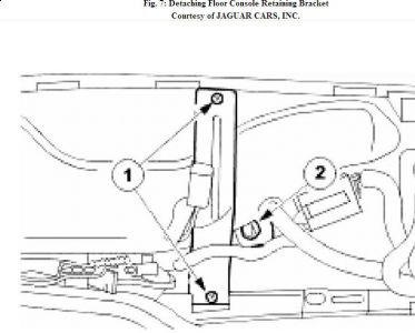

https://images.2carpros.com/forum/automotive_pictures/30961_stdesc1_1.jpg
https://images.2carpros.com/forum/automotive_pictures/30961_stdesc2_1.jpg
https://images.2carpros.com/forum/automotive_pictures/30961_st1_2.jpg
https://images.2carpros.com/forum/automotive_pictures/30961_st2_2.jpg
