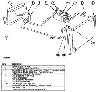

Where can I find the low pressure port(to re-charge freon) on a 2000 Jaguar. I know I have to lift the car, but where exactly.
Thanks

Low side is at no.5
