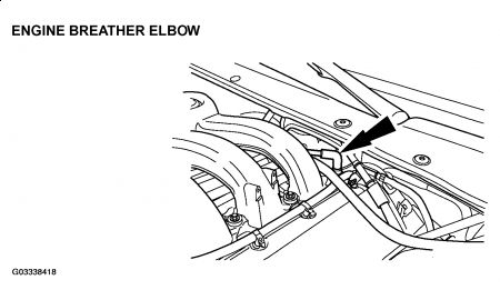

Yes, i'm afraid only dealers in the U.S. have the software to reflash the computer ... I have been thinking about your idle problem and remebered this TSB ! POOR IDLE/CHECK ENGINE MIL - V6 ENGINES - IMPROVED BREATHER ELBOW - SERVICE ACTION S158 TECHNICAL SERVICE BULLETIN Reference Number(s): S303-S158, Date of Issue: July 2003 JAGUAR:2000-01 MY, S-TYPE 3.0L VIN:L00001-L86901 SECTION:Engine System Related Ref Number(s): S303-S158 ARTICLE BEGINNING Issue S-TYPE 3.0 liter V6 vehicles, within the above VIN range, are equipped with a 3/8-inch bore 90 ° rubber elbow as part of the engine breather system. This elbow is manufactured from a type of rubber that is subject to degradation from the gas and vapor that pass through it, resulting, after a period of time, in air being allowed to enter the intake system of the engine. Vehicles within the above VIN range may exhibit poor idle and a 'check engine' MIL may be displayed on the instrument cluster. Action On 2000-01 S-TYPE 3.0L vehicles within the above VIN range, install a revised breather elbow, at the next available opportunity. Also remembered there was an updated valve body introduced for inside the transmission on this year vehicle 5-SPEED TRANSMISSION - ERRATIC OR HARSH SHIFTS - VALVE BODY KIT AVAILABLE - REPAIR PROCEDURE TECHNICAL SERVICE BULLETIN Reference Number(s): S307-19, Date of Issue: June 2005 JAGUAR:2000-02 MY S-TYPE VIN:L00001-M44997 SECTION:Transmission System Related Ref Number(s): S307-19 ARTICLE BEGINNING Issue Some 2000-02 MY S-TYPE vehicles within the above VIN range may exhibit erratic or harsh transmission shifts. This can be caused by valve body or control solenoid failure. Action NOTE:Check for connector/wiring and Powertrain Control Module (PCM) faults, ensure the transmission fluid is clean and there is no debris in the sump. Refer to Global Technical Reference GTR Workshop Manual, section: 307-01 - Diagnosis and Testing. Any faults other than the valve body kit replacement, are to be carried out as a separate Warranty Claim. When a fault has been confirmed with the valve body or control solenoid, a new valve body kit must be installed. Follow the Service Instruction. check/replace the elbow connector and test vehicle .. although i'm not sure both faults are connected .. check to see if both are still occuring ?
https://images.2carpros.com/forum/automotive_pictures/266999_jag_83.jpg
let me know
https://images.2carpros.com/forum/automotive_pictures/266999_AAA2_1047.png
Mar 12, 2010 at 8:11 PM
RINGKING
  • 12 POSTS
That is a lot of good information, and I looked for the elbow but the picture doesn't look the same as my car. All that stuff was for the 3.0 V6 I think, and mine is the the 4.0 V8. I just don't know what to do anymore.
