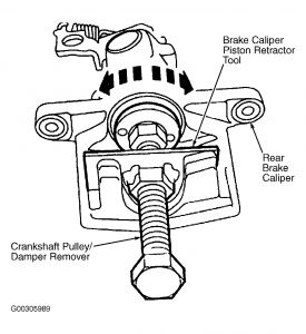

how do i compress the rear calipers on this car?

what model jaguar is it?
Oct 26, 2008 at 2:36 PM
TRAILERMAN
XTYPE
Oct 27, 2008 at 1:13 PM
BLACKOP555
  • 10,386 POSTS
regular x-type.
post back if you have x-type sport.
you will have to use a brake caliper piston retractor tool (206-080+ and crankshaft pulley/damper remover (303-588). then you can fully retract the rear brake caliper piston into the housing.

https://images.2carpros.com/forum/automotive_pictures/66751_jaguar_1.jpg

I have already rented the tool and tried it. it won't budge. I bought a new caliper and threw the old one into the woods. Problem solved.
