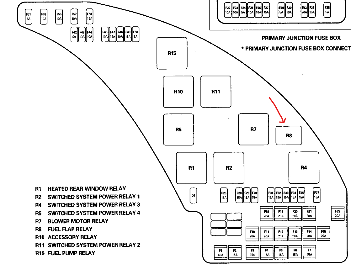

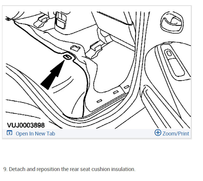

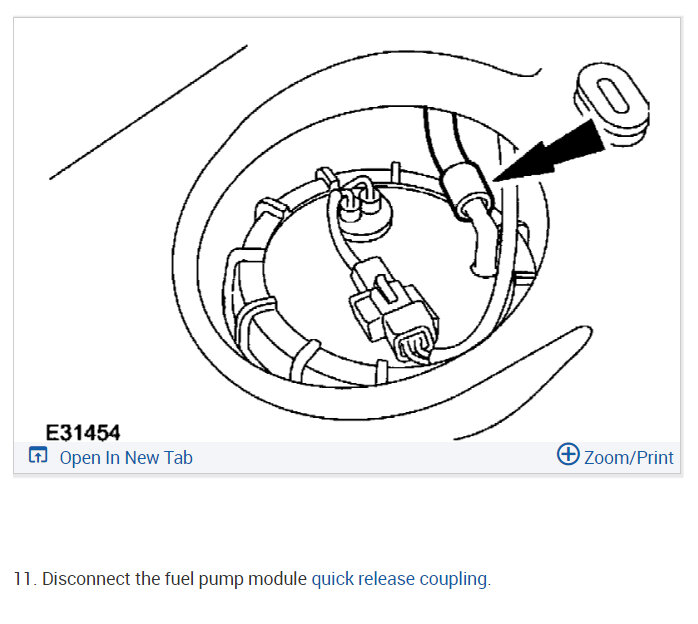

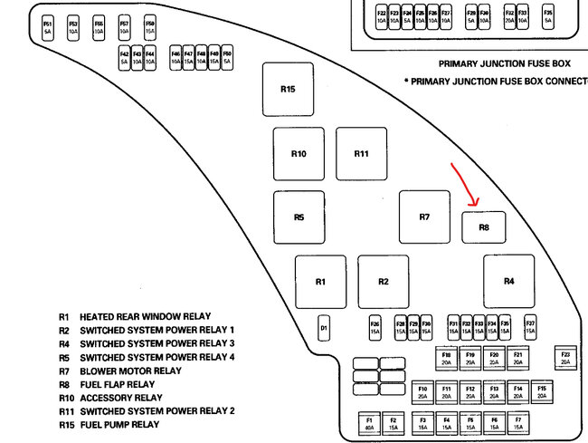

I have a 03 Jaguar s-type that won't start and it is giving me a "fuel data error" message. What is the cause????

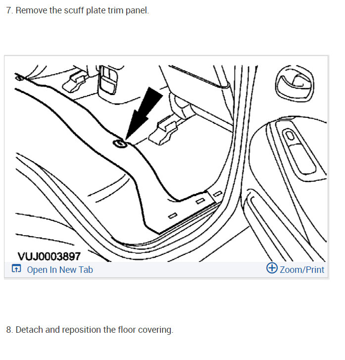

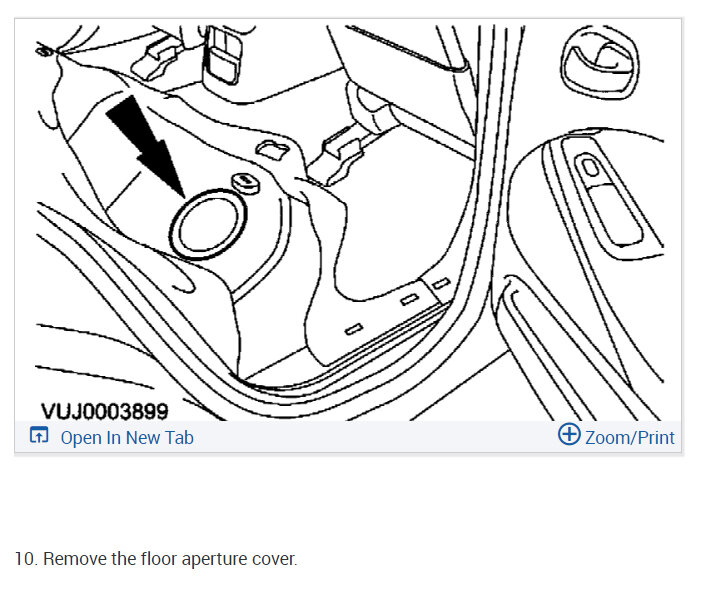

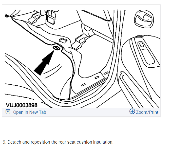

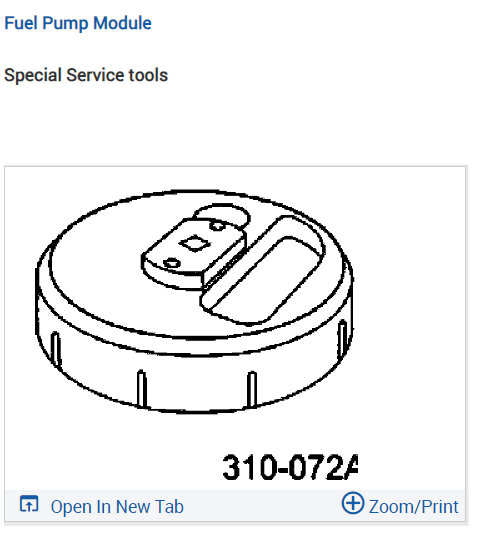

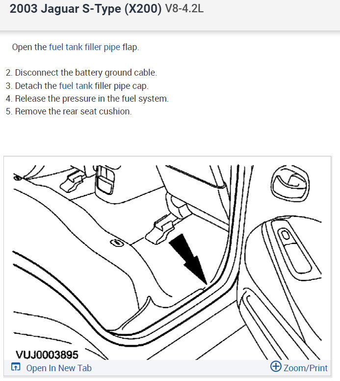

Yep, this error is present when the fuel pump or transfer pump is not working in most cases. Start by checking the fuses and fuel pump relays, here is the relay location. The fuel pumps are under the rear seat. I have included how to change out he fuel pump in case you need them. Check out the images (below). Please let us know what happens.
