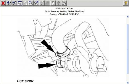

It appears that my AC is stuck on a single cold setting. Whenever I adjust the electronic temperature controls, the air temperature does not change.
The air temperature is currently rather cold...probably around 70 degrees. That is normally perfect for Florida where I live. Now that it is cooling off, however, I would like to warm it up a little.
Whenever I bump up the temperature degree, the air temperature stays just the same...even if I bump the electronic control up to 82 degrees...
Thanks for the help!!!

Hi ufmseymour, Thank you for the donation. Your symptoms refers to the heater not working and you need to check the following. 1. Clogged heater hoses or core. 2. Faulty Auxiliary Coolant Flow Pump. 3. Bad temperature control. 4. Faulty vent controls.
https://images.2carpros.com/forum/automotive_pictures/192750_HeaterAuxPump02Jaguar_1.jpg
