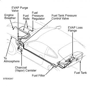

Car has been running a bit sluggish. Advice from one mechanic is to first try fuel filter, since increased use of ethanol loosens deposits and varnish in fuel system, sometimes clogging filter. Looking for help in locating the fuel filter.

The fuel filter is near the tank this guide will help walk you through the repair with a diagram below to show you on your car the location. https://www.2carpros.com/articles/how-to-change-a-fuel-filter Check out the diagrams (Below). Please let us know if you need anything else to get the problem fixed.
https://images.2carpros.com/forum/automotive_pictures/266999_jag_32.jpg
