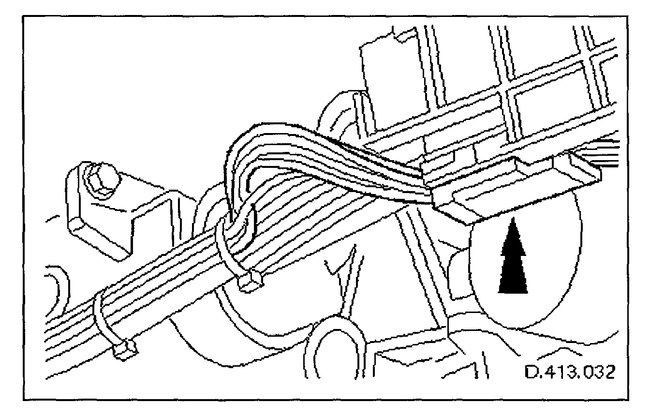

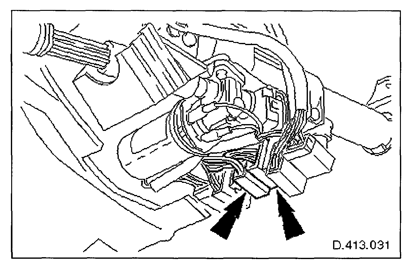

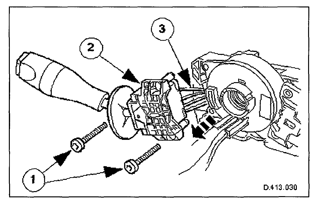

How do I access the wiring on my turn signal stock for troubleshooting?
120,000 MILES • 4.0L • V8 • 2WD • AUTOMATIC
STEVE CLOUTIER
  • 13 POSTS
Do I need to remove the steering wheel as some on the internet suggested? Hope not but what ever i need to do. I am apprehensive about the air bag so any suggestions or advice is welcome.
Thanks,
Steve
Nov 28, 2020 at 2:48 AM
  • 110,251 POSTS
You can remove the shroud around the column, but that isn't going to get you to the multi function switch. To access that wiring, the steering wheel does need removed. As far as the air bag, here is what the manual says.
Warning: following disconnection of the battery, a period of at least one minute must be allowed to elapse before any work is carried out on an air bag module.
I would allow it to sit for approximately 20 minutes.

Here are directions for removal of the switch. The attached pics correlate with the directions.
________________
1999 Jaguar XJ-8 Sedan (X308) V8-4.0L (AJ27)
Flasher/Headlamp/Trip Switch
Vehicle Sensors and Switches Sensors and Switches - Lighting and Horns Combination Switch Service and Repair Procedures Flasher/Headlamp/Trip Switch
FLASHER/HEADLAMP/TRIP SWITCH
Removal
1. Disconnect battery ground cable.
2. NOTE: Steering wheel must be in straight ahead position.
Remove steering wheel.
pic 1
3. Displace cancellation module connector from mounting bracket and disconnect.
pic 2
4. Displace flasher/headlamp/trip switch connectors from mounting bracket and disconnect.
- Cut and remove appropriate harness securing ties.
pic 3
5. Remove switchgear.
1. Remove two screws which secure switch assembly/cancellation module to mounting bracket.
2. Displace switchgear from mounting bracket.
3. Route switchgear harness through mounting bracket and remove switchgear.
Installation
1. Installation is reverse of removal.
________________________
Let me know if this helps.
