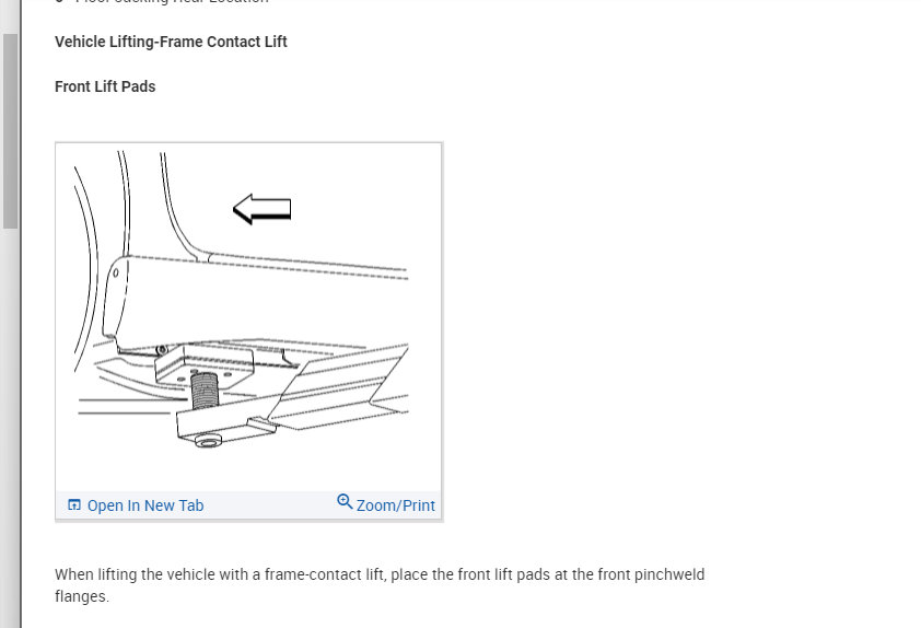

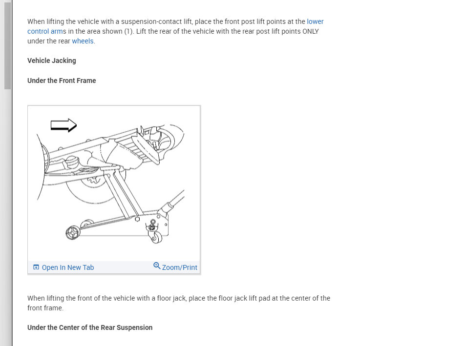

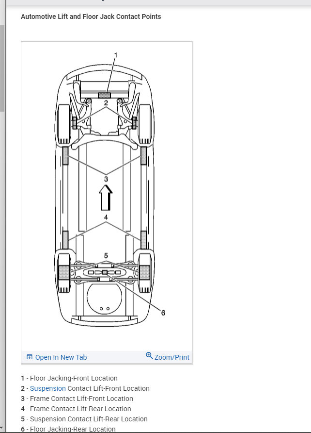

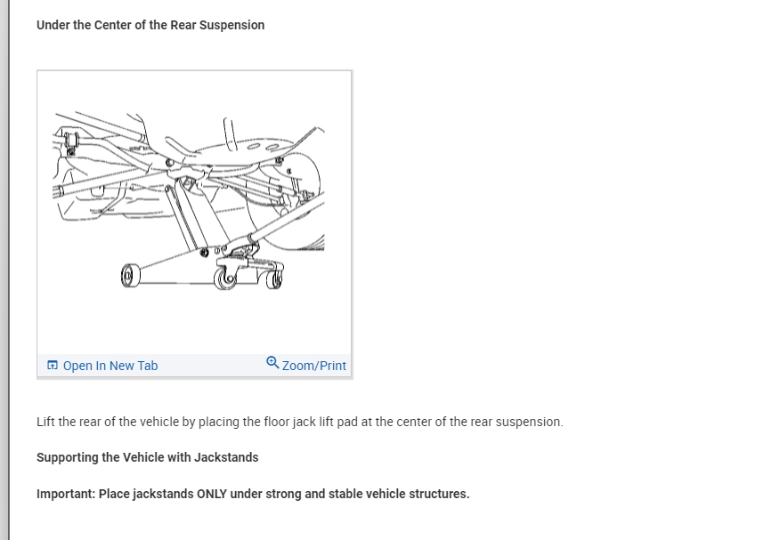

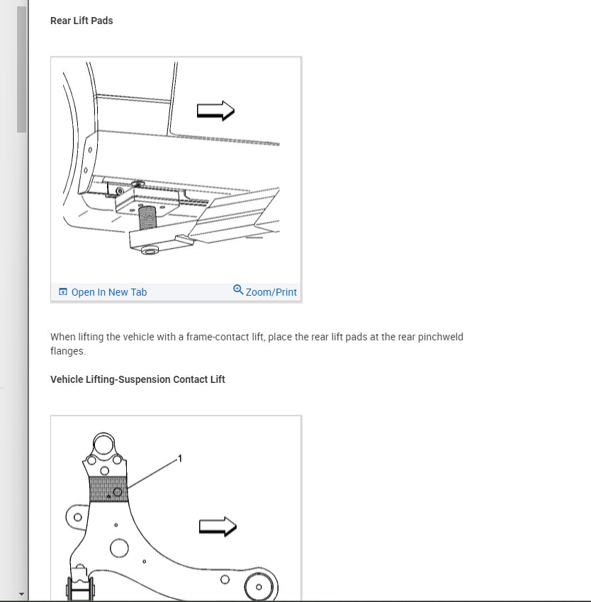

Where can I place my floor jack to lift my car so that;
1. lift both front tires.
2. lift both rear tires.
3. lift both side tires.
If possible, pictures would be appreciated.
Aug 7, 2017 at 2:46 PM

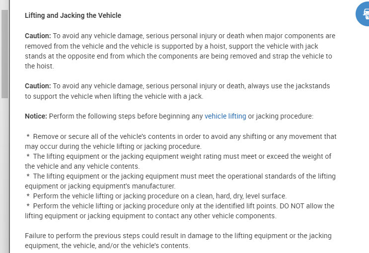

There are a few different lift point options, however, here is a guide that we have that will help with this exact issue:
Below you find the info from the manual on how to lift the vehicle in each different method.
Please run through this and let us know what questions you have. Thanks
