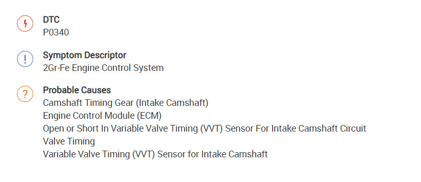

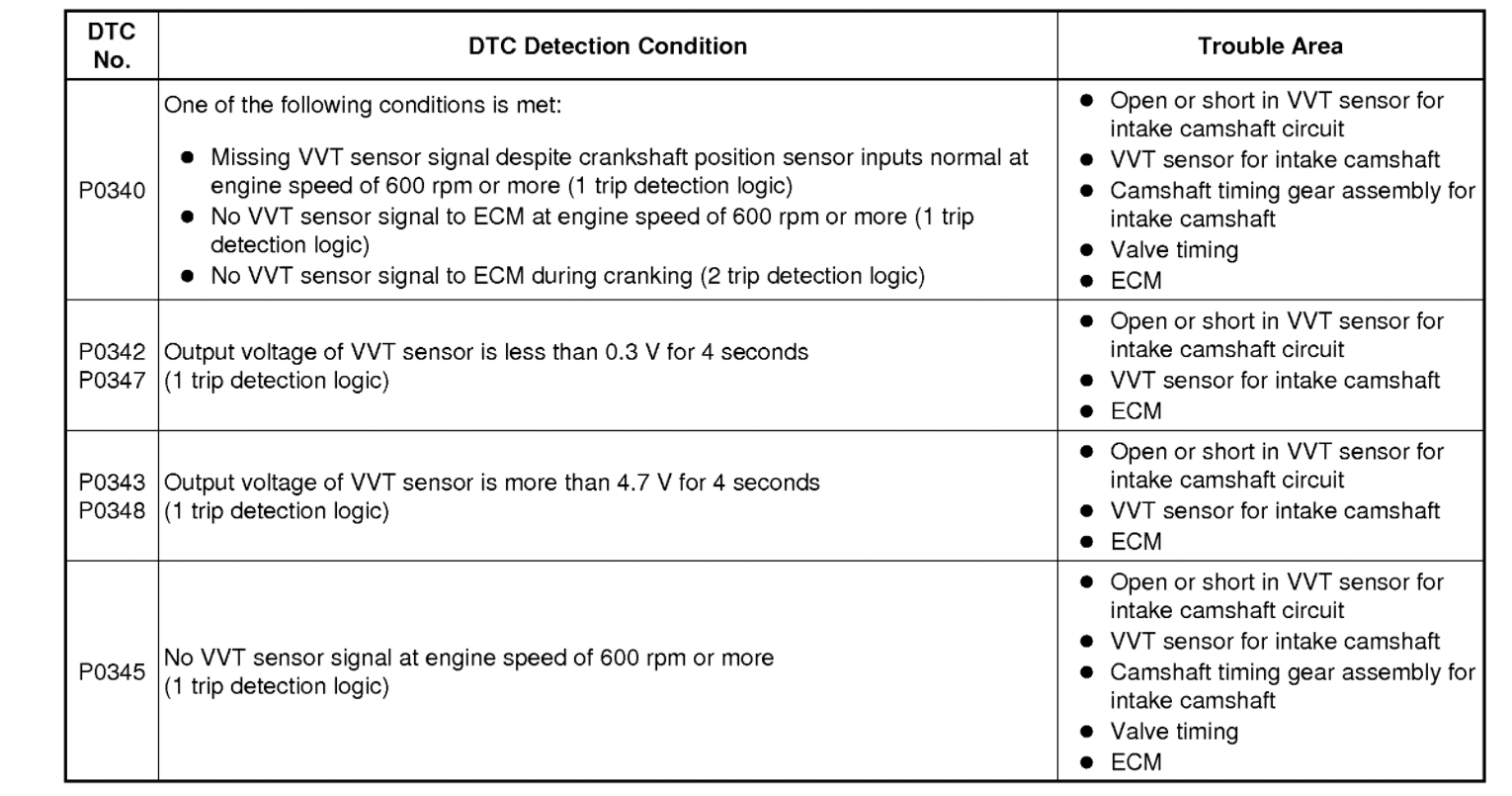

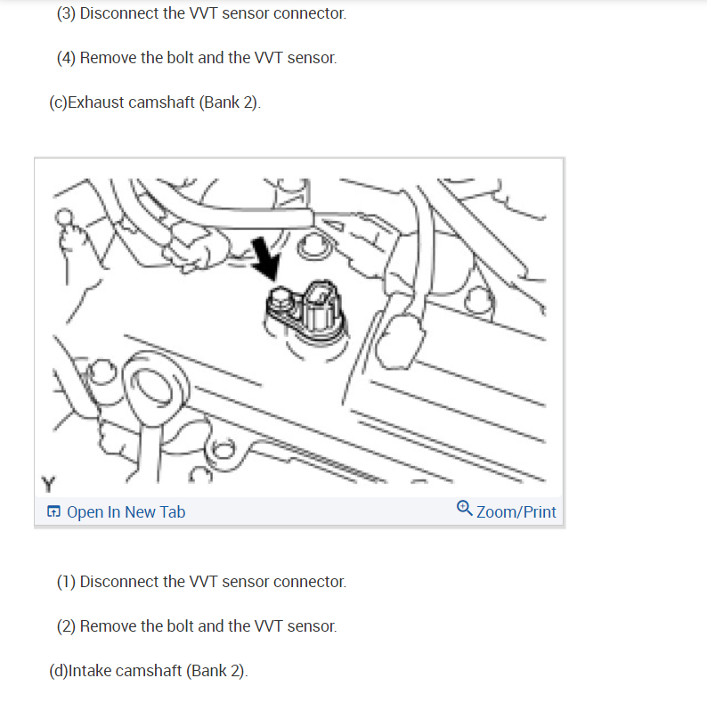

My car jack on motion and brings out this code p0340.
Apr 27, 2021 at 7:56 PM

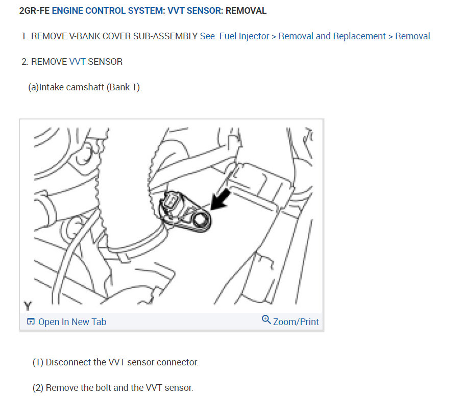

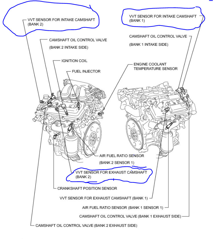

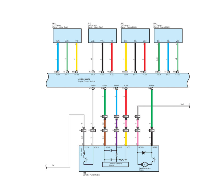

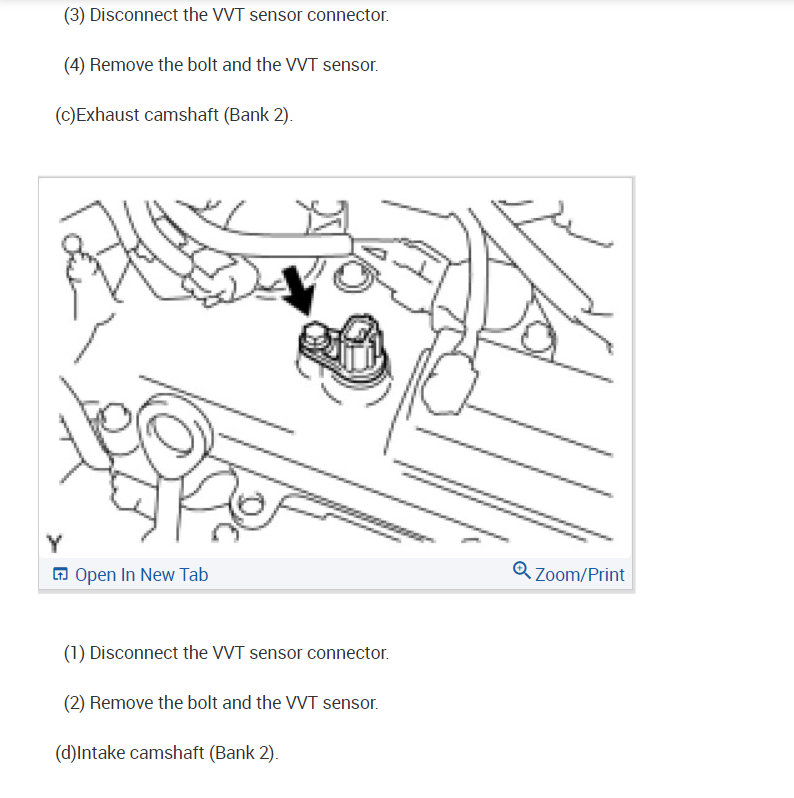

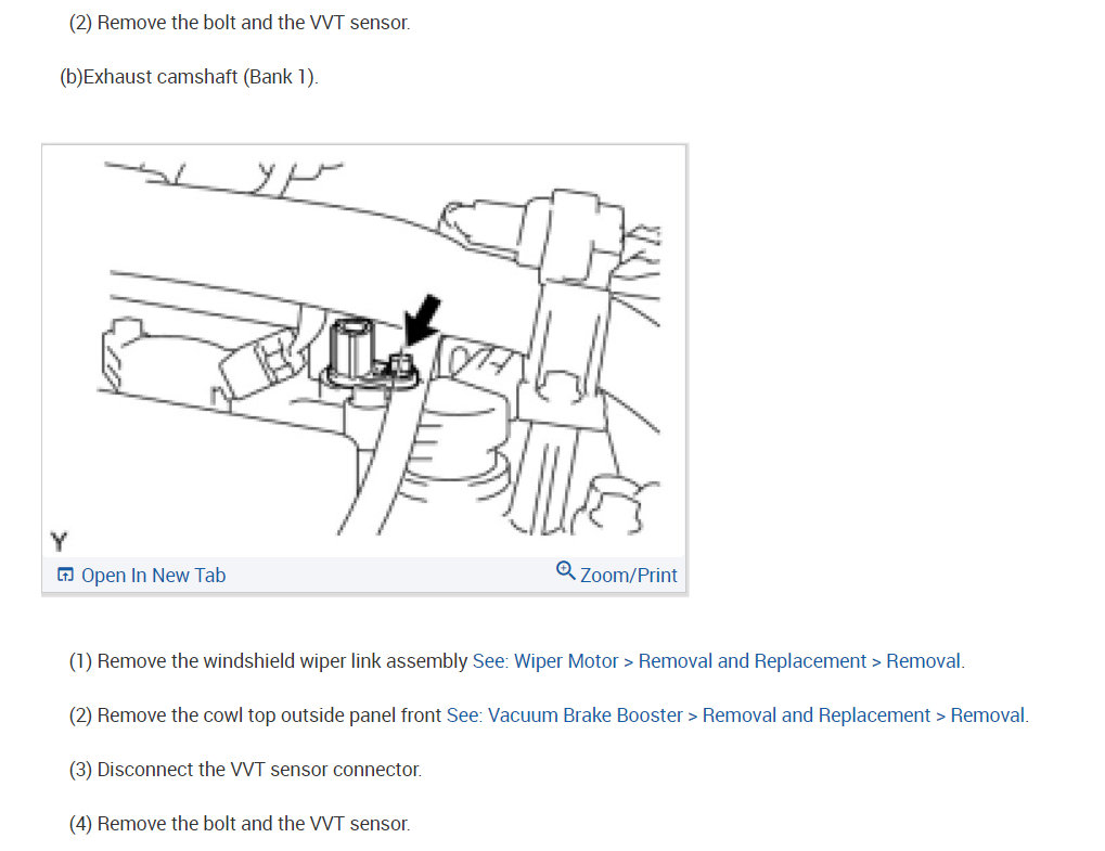

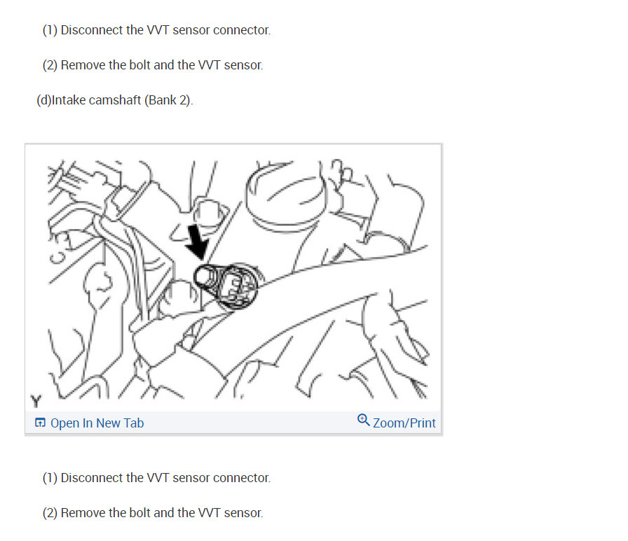

Good morning,
I attached a possible issue for this code. It references a camshaft position sensor. I attached a wiring diagram and the locations for you of the sensors.
https://www.2carpros.com/articles/camshaft-angle-sensor-replacement
