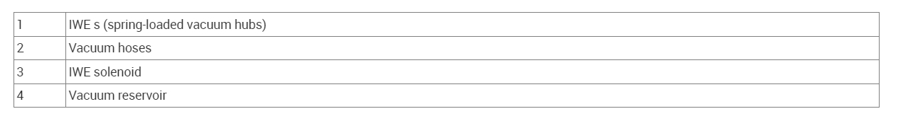

It sounds like the check valve in the IWE solenoid is not working. I would swap it out for a new one which should fix it. Check out the images (below). Please let us know what happens.
