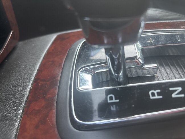

I went and had my Cadillac tested because of the puttering, rough idle and poor gas mileage. All of this started after I put $40.00 in my fuel tank from Walmart. After getting my results I went and bought a new fuel cap. Still running ragged and even died once on me and haven’t drove it since. Today I went and opened the door and noticed the dash lights did not light up. So, I put my key in the ignition to see if it would start and now the key is stuck in the ignition and also the car wasn’t properly put in park. I read on here there is an ignition reset button somewhere in the steering wheel column but i don’t see it.

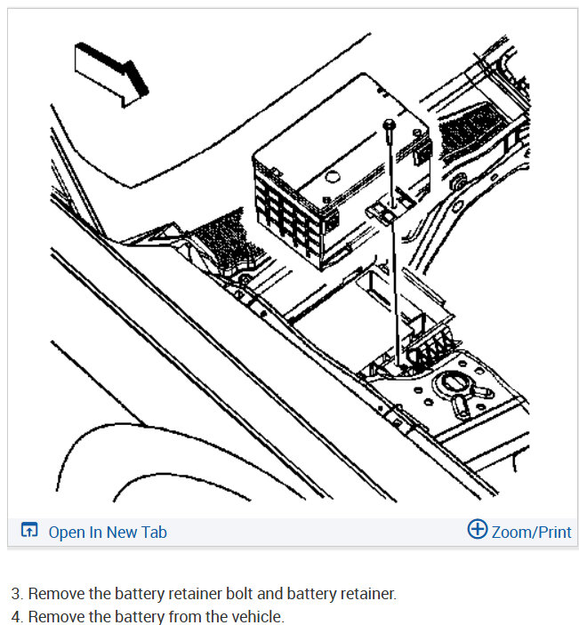

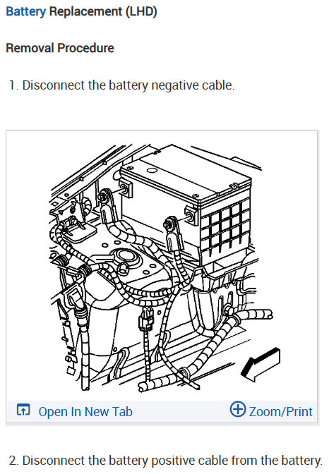

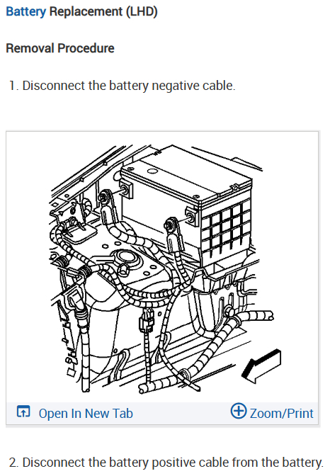

It seems like you have three or four different issues. If the battery is dead, then the ignition system (key) with not work right so this is where I would start. I would turn the headlights on to see if there are bright, please go over this guide to help:
You can also remove the battery and take it to the auto parts store, and they can test it. I have included how to remove the battery in the images below. These codes will not have anything to do with the park or not starting issue so please start new threads for each.
