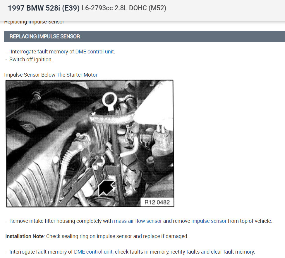

It's not getting any sparks in the plugs
1997 BMW 528
236,000 MILES • 2.5L • 6 CYL • 2WD • AUTOMATIC
HDJSHSKAHSKSH
I can't get it to start at all we already changed the coil?
Feb 1, 2015 at 1:22 AM
  • 110,244 POSTS
Have you checked the coil? Have you checked to see if there is power to the crank sensor?
Feb 1, 2015 at 9:27 PM
  • 55,433 POSTS
I would replace the crankshaft impulse sensor which will cause this problem. We should run the codes as well to see if any are stored.
Here is the location of the sensor so you can swap it out which should fix the problem. Check out the images (below). Please let us know what happens.
