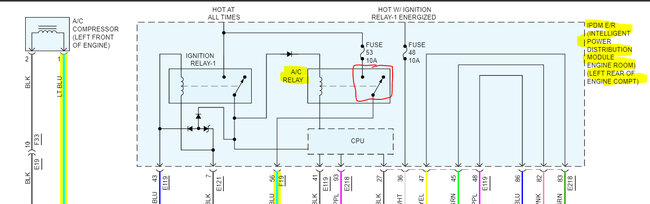

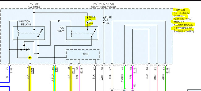

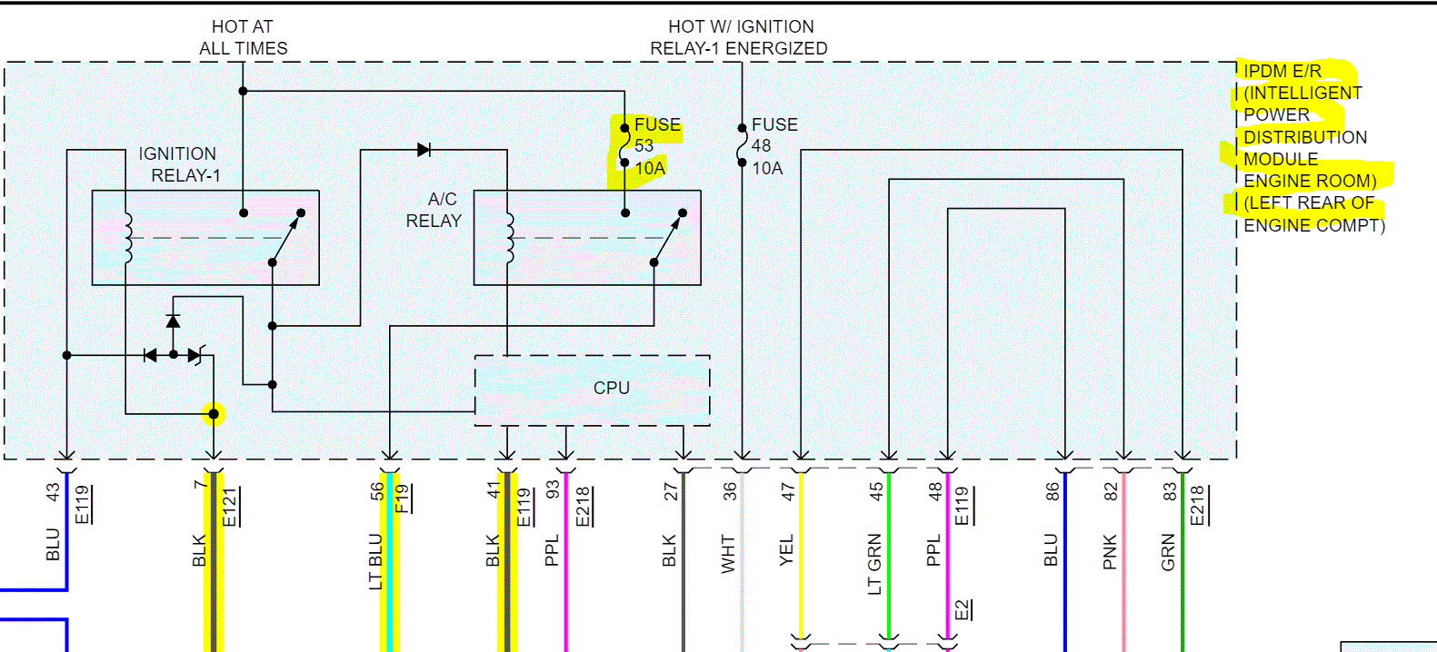

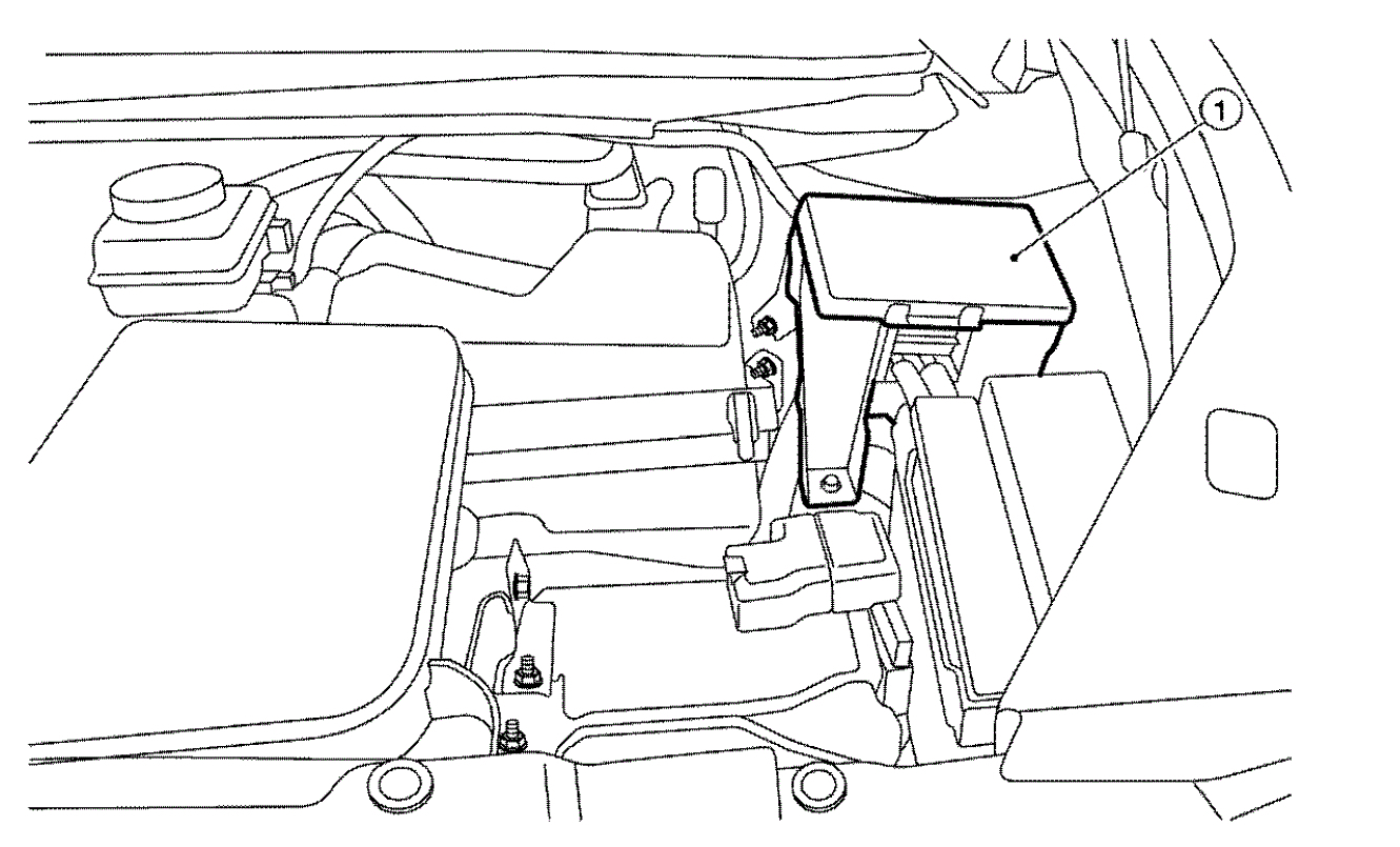

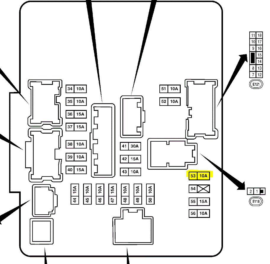

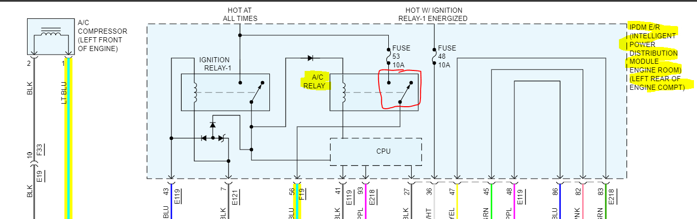

The first thing I recommend is to check fuse 53 in the intelligent power distribution module. This is the fuse that powers the A/C compressor clutch coil. If it failed, the compressor won't engage.
When you check it, confirm the fuse is good and also confirm there is power to and from it. Here is a link you may find helpful:
Also, take a look through this link and let me know if anything helps:
Below, pic 1 shows where the IPDM is located, pic 2 shows the fuse to check, and pic 3 is the fuse box wiring schematic.
Let me know what you find or if you have other questions
Jun 2, 2022 at 8:33 PM

Thank you for your response. Today we checked all of the fuses, all of them were just fine.
We bought refrigerant and checked that out as well. For some reason it is all the way in the red and that is with none added. I read in the link you posted that the compressor will automatically shut off and not run if the refrigerant is too low or overfilled, could that be the reason why the compressor isn’t moving? Also, Afterwards we checked the ac compressor. It did not move once even with the air fully engaged and turned on.
Does this mean I’ll need to buy a new compressor? Is there something else I should check before doing that?

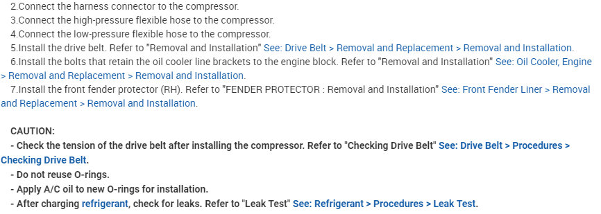

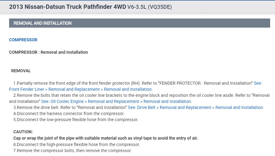

Joe, I’m still without A/C. However, I did take my car to the garage, and they started it is the compressor and wanted to charge me $800, obviously I can’t afford that. So, with that being said do I need to buy a condenser with the compressor?? What should I do? I already have the new compressor. Just need some guidance.
Thanks, sorry for the long time to respond, life got in the way.
Oct 4, 2023 at 8:53 AM
  • 110,194 POSTS

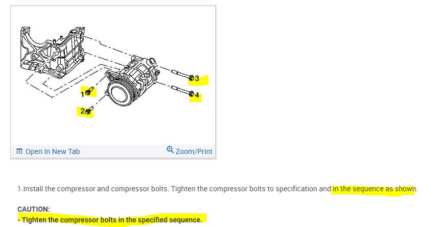

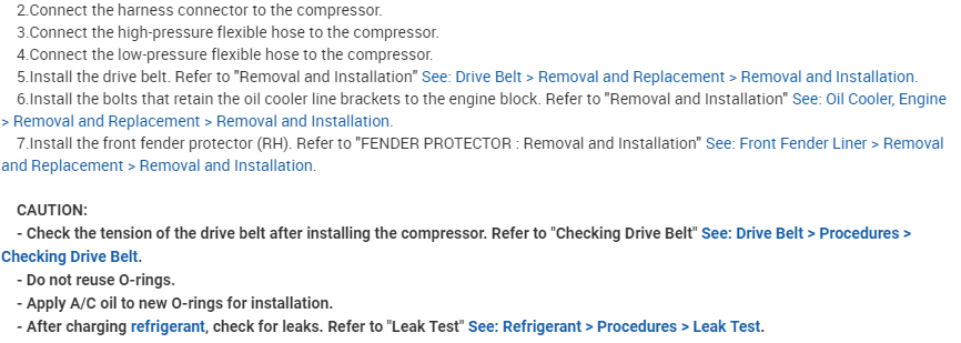

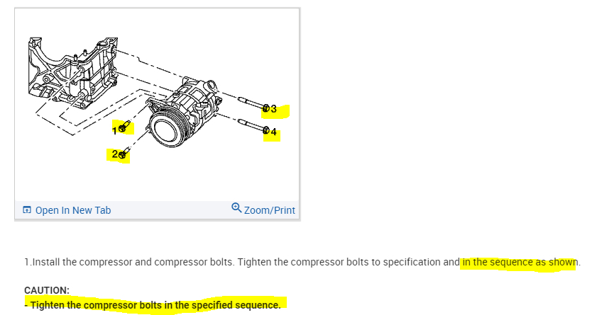

No problem whatsoever. I'm glad you're back. As far as replacing the compressor, I attached the manufacturer's procedures below. They are somewhat vague. For example, they don't explain how O-rings are replaced or adding PAG oil or anything like that. So, here is a link that will explain those things to you:
https://www.2carpros.com/articles/replace-air-conditioner-compressor
If you look below, I attached the directions from my manual. Take a look through things and let me know if you have questions or if it helps.
See pics below. Note: If the original compressor had internal damage/failure, the system will need to be flushed.

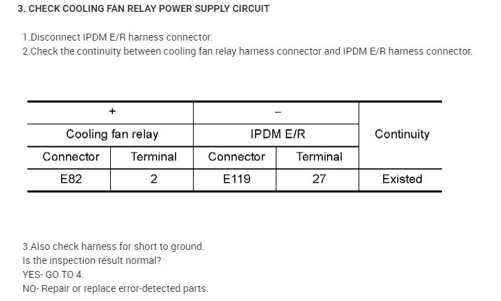

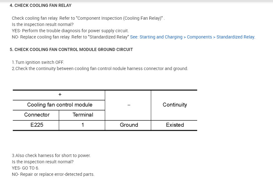

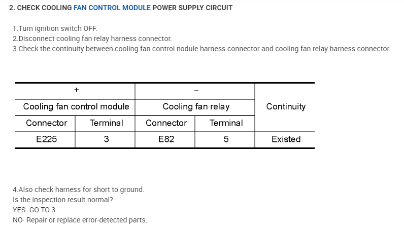

Okay, so there is another issue then? Because my fans don’t turn on period.
Oct 7, 2023 at 3:05 PM
  • 110,194 POSTS

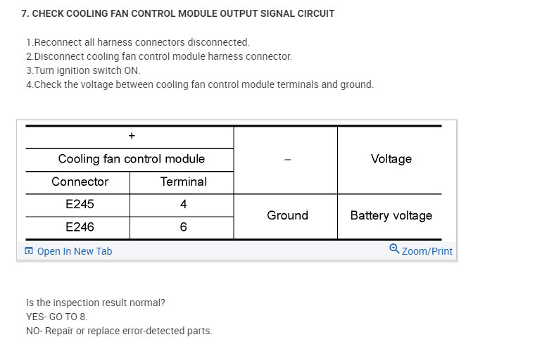

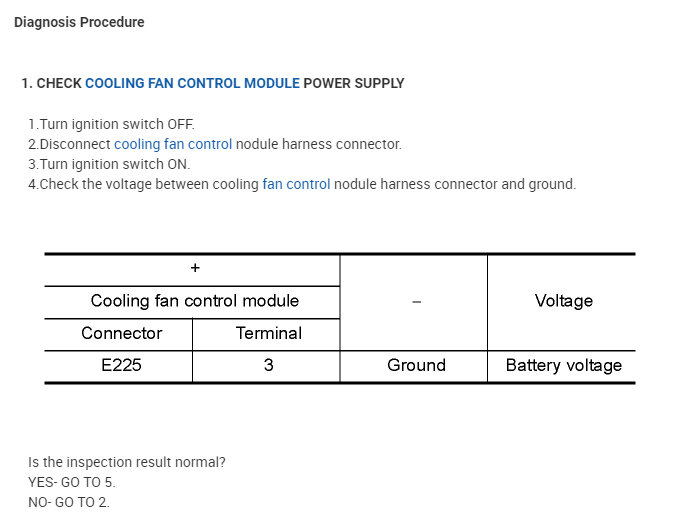

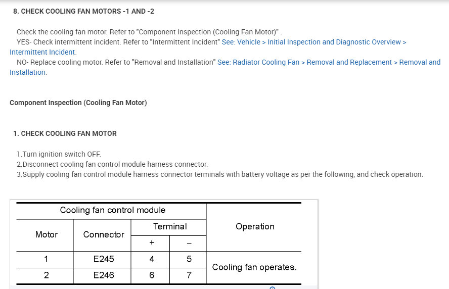

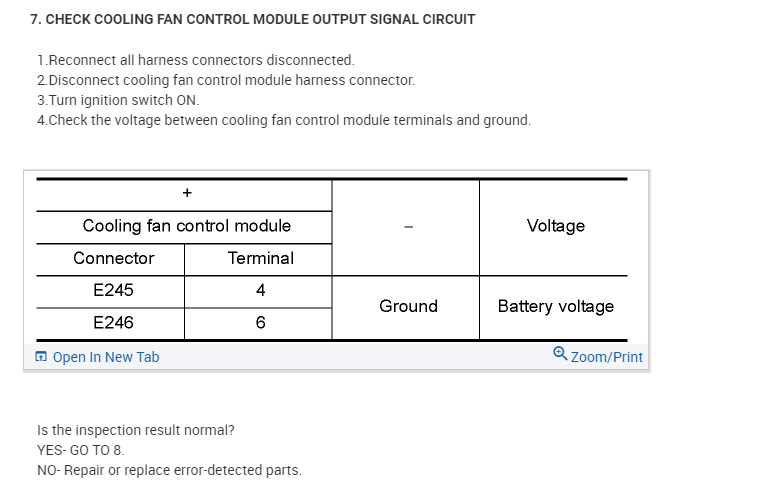

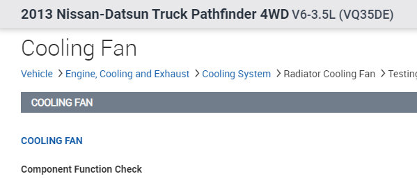

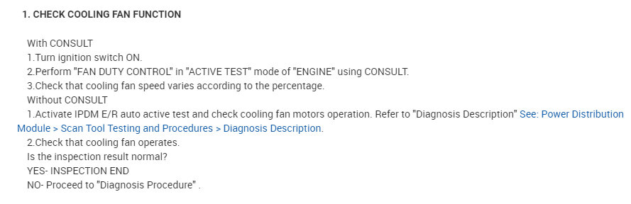

Ashely, if you let the vehicle sit and idle, will the engine overheat? I'm not suggesting you do that, but once a specified coolant temperature is reached, the cooling fan should turn on.

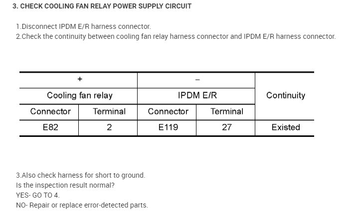

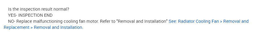

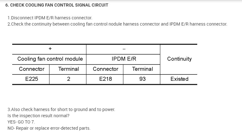

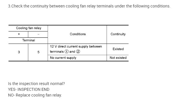

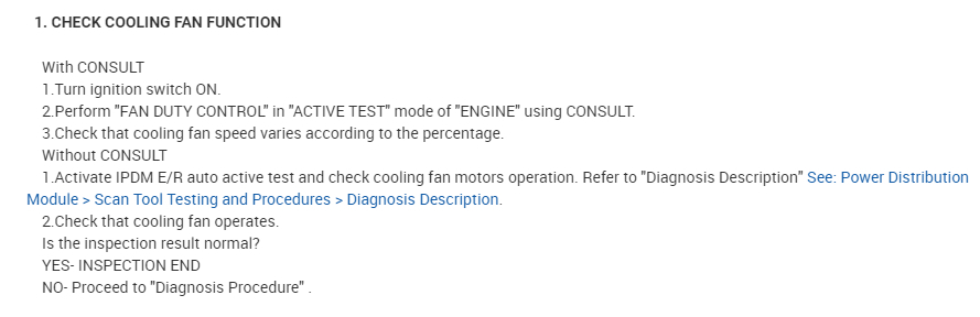

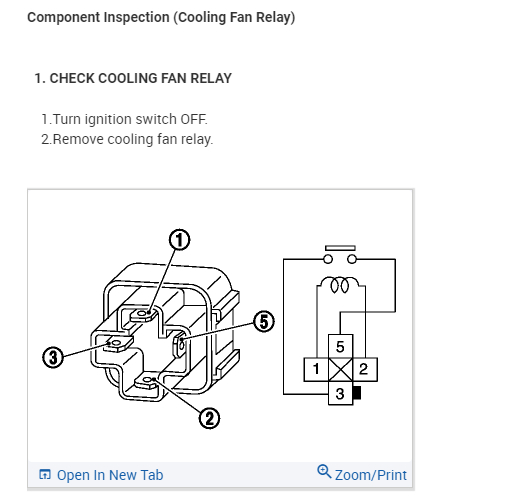

If it will overheat, then we need to check a few different things. I attached the diagnostics for the fan motor below. There are several different tests. Some require the use of a scan tool that can communicate with the vehicle. Take a look through them and let me know if you are comfortable performing them.
Oct 7, 2023 at 9:24 PM

Joe, yes if it sits idle long enough it will start to overheat. No fans kick on at any point.
What are the first two images that you put? I’m a little confused on how to do that? The others I can do.
Oct 8, 2023 at 3:40 AM
  • 110,194 POSTS
The first two pics are the first test. A bidirectional scan tool is needed. Basically, the scan tool tells fans to turn on. It is used to see if the electronics between the power supply and fan motors are working.

I attached a pic below showing the compressor relay. On the relay, you will find four pins. On the plastic portion, there will be four numbers, 85, 86, 87, 30. If you place a jumper wire into pins 30 and 87, that will send power to the compressor clutch, and it should engage. If you are comfortable doing it, just make sure to wear eye protection at a minimum. You should be fine, but I'm not sure what is happening yet.
Here is a link that explains how to test a relay and its circuit. It provides a more detailed explanation of the circuits.
Let me know your thoughts and questions.
See pic below.
