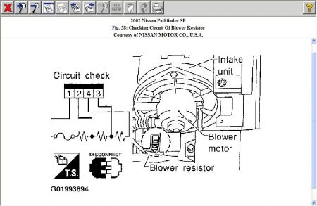

blower fan used to come on them go off briefly but would eventually stay on. Then it would only run on high. now it doesn't work at all. compressor seems to work ok, fan run when I ran it on 12v. Fuses are ok. now what?
Jul 24, 2008 at 8:02 AM
  • 75,988 POSTS
Test the blower motor resistor and the control switch
https://images.2carpros.com/forum/automotive_pictures/12900_blower_motor_resistor_5.jpg
Jul 24, 2008 at 8:44 AM
TOM BOSTWICK
where are they located?
Jul 24, 2008 at 9:13 AM
  • 75,988 POSTS
The motor blower is located below right side of dash also see pic for the resistor

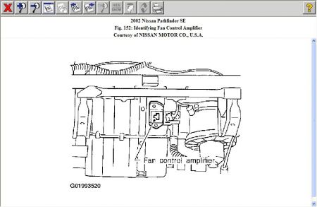

TOM BOSTWICK
are these replies to auto air? Because I am not finding the blower resistor or switch. I have a auto air system and this seems to be a manuel air answer
Thank You
Jul 24, 2008 at 10:58 AM
  • 75,988 POSTS
I have a auto air system and this seems to be a manuel air answer -For auto start by testing the fan control amplifier
