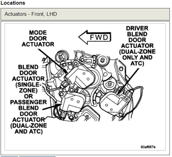

I have replaced filled fluids, flushed heater coil, and i still do not have heat. what do i do next?
Jan 2, 2018 at 5:59 AM
  • 55,519 POSTS

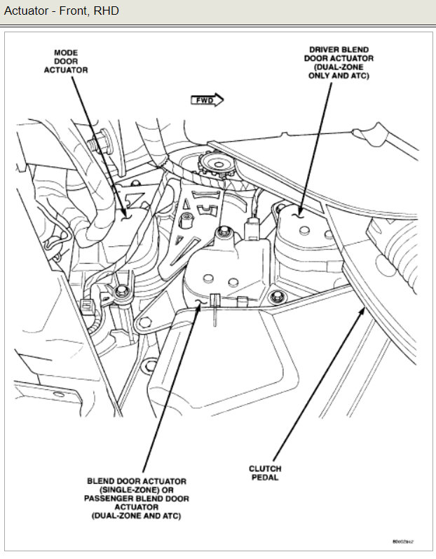

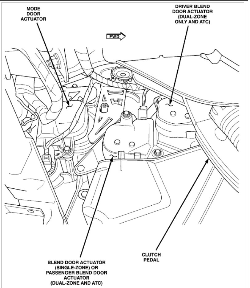

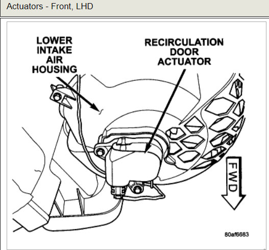

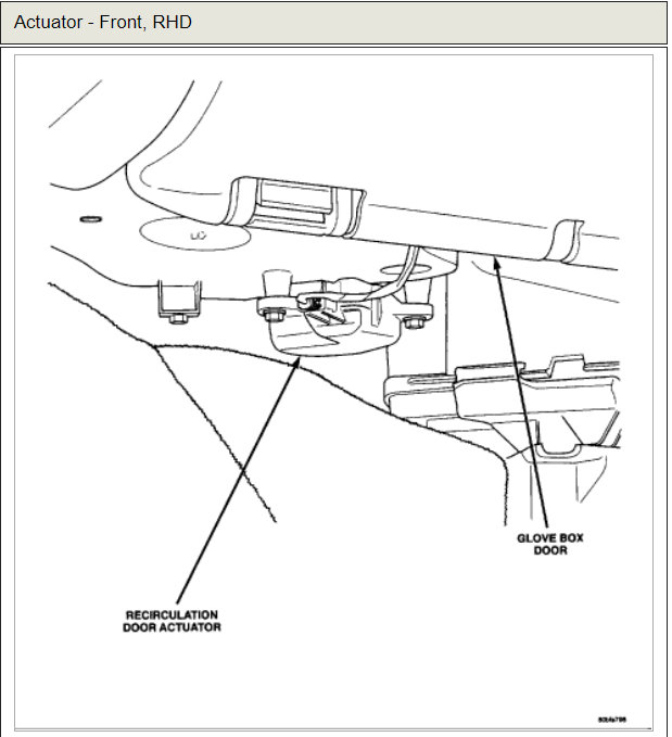

It sounds like a temperature blend door actuator has let go. Here is a guide to help you see what you are in for when changing it and the diagrams below to show you how ti will be on your car
and
Please get back to us.
