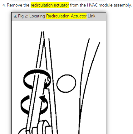

I have four air vents, one on the driver's side door two in the middle, and one on the passenger side. When I turn on my air my side (the driver's side) vent blows out cold air, and the other three blow out warm air,. Sometimes I can get it to work like normal. I took it to a shop to get it fix, and I was told that it was my air recirculating actuation door, and the part was $90.00, great! But all in all total cost is $848.00, I (lol) it is sad. I am going to try to do it myself. Is it one door I am looking for under my dashboard (glove box)? Thank you for your time and helping me. Sherri :)

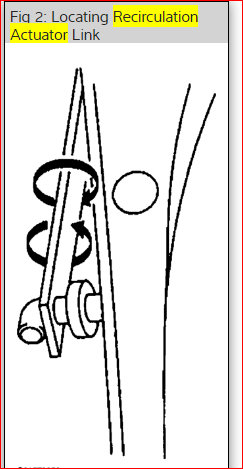

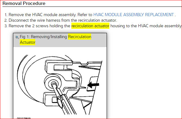

Yes, that is a blend door actuator problem. I have attached a tutorial shoeing what is involved in the replacement. I have also attached a few pictures and a step-by-step instruction. The actuator is located on the HVAC box located on passenger side under the dashboard. Hope this helps and thanks for sing 2CarPros.
