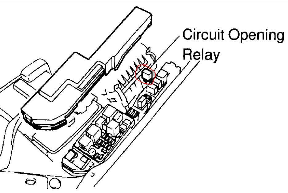

Fuel pump not getting power?
1999 TOYOTA CAMRY
201,000 MILES • 2.0L • 4 CYL • 2WD • AUTOMATIC
CHEYNE
MEMBER
1 POST
Looking for the relay. Looking for the relay.
Nov 30, 2019 at 5:21 AM
DANNY L
Experienced Mechanic
5,648 POSTS
Hello, I'm Danny.
The fuel pump relay is called a "circuit cut relay" located under hood in the relay box.Here is a tutorial showing how to test a relay:
I've attached a picture below of its location.Hope this helps and thanks for using 2CarPros.
