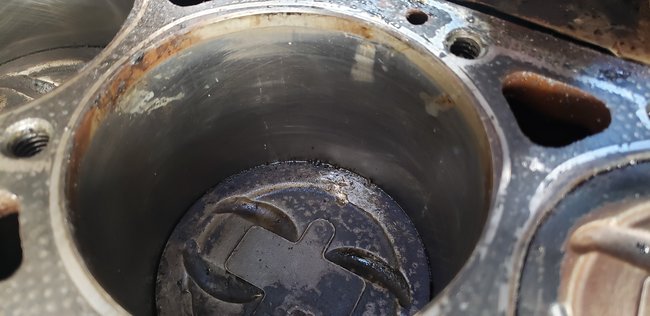

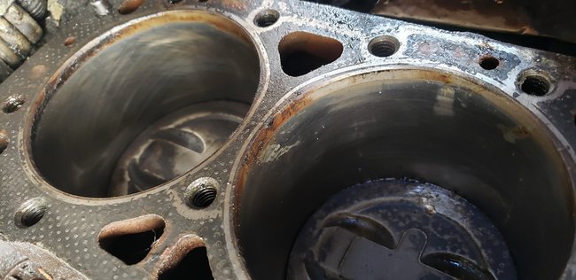

JUSTIN SOLIZ
  • 7 POSTS

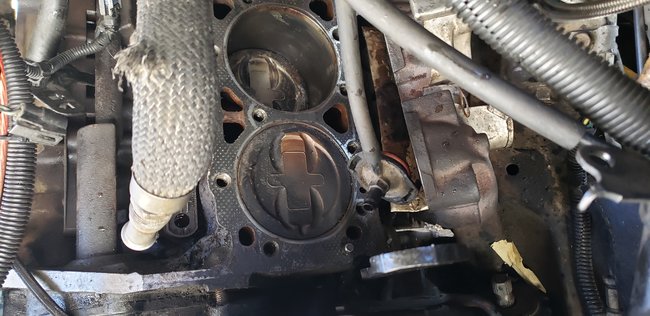

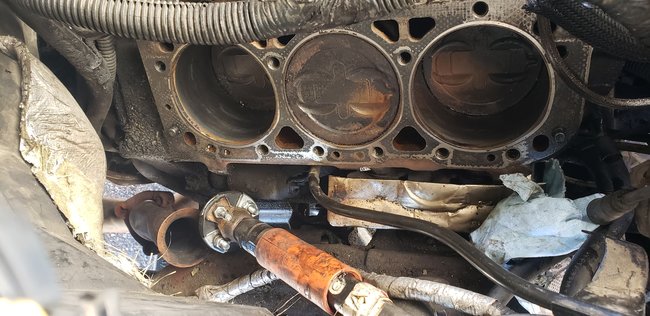

So got both cylinder heads off and i do have a bent rod. so i will need to replace all of those obliviously, but i will attach an image of my pistons so you can tell me if i am okay.
Feb 17, 2019 at 2:51 AM
JUSTIN SOLIZ
  • 7 POSTS
Here they are.
Feb 17, 2019 at 2:52 AM
JUSTIN SOLIZ
  • 7 POSTS
One piston wall has a hairline fracture on part of it but it doesnt go all the way to the bottom or top.
Feb 17, 2019 at 2:54 AM
SCGRANTURISMO
  • 4,897 POSTS
Hello again,
Sorry to hear about your valves. The pistons look okay to me from the pictures. That's a decision that you will ultimately have make though. Do you need factory instructions on rebuilding the cylinder heads for your vehicle? Let me know one way or another please.
Thanks,
Alex
2CarPros

I did not see that last post. I would not take a chance with that engine block. At the very least it looks like a new sleeve will have to be put into that cylinder. I am not telling you to do this but if it were me, I would consult a local machine shop of your choosing. I have no information to give you on this procedure. Let me know what happens.
Thanks,
Alex
2CarPros
Feb 17, 2019 at 5:57 AM
JUSTIN SOLIZ
  • 7 POSTS
You are talking about the one with the small line in it? It doeskin have an indent on the walls when I ran my finger around it .
Feb 17, 2019 at 6:09 AM
SCGRANTURISMO
  • 4,897 POSTS
Okay. I am just worried that you will get your engine reassembled and then find out you have coolant leaking through your cylinder wall and have to tear it back down again. It is entirely up to you. I will get you those instructions in a few. I am answering this on my cell phone and will get those when I get home to my computer.

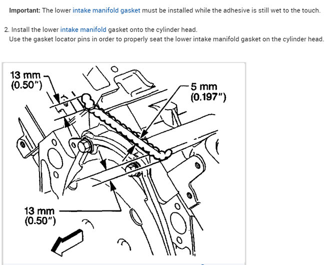

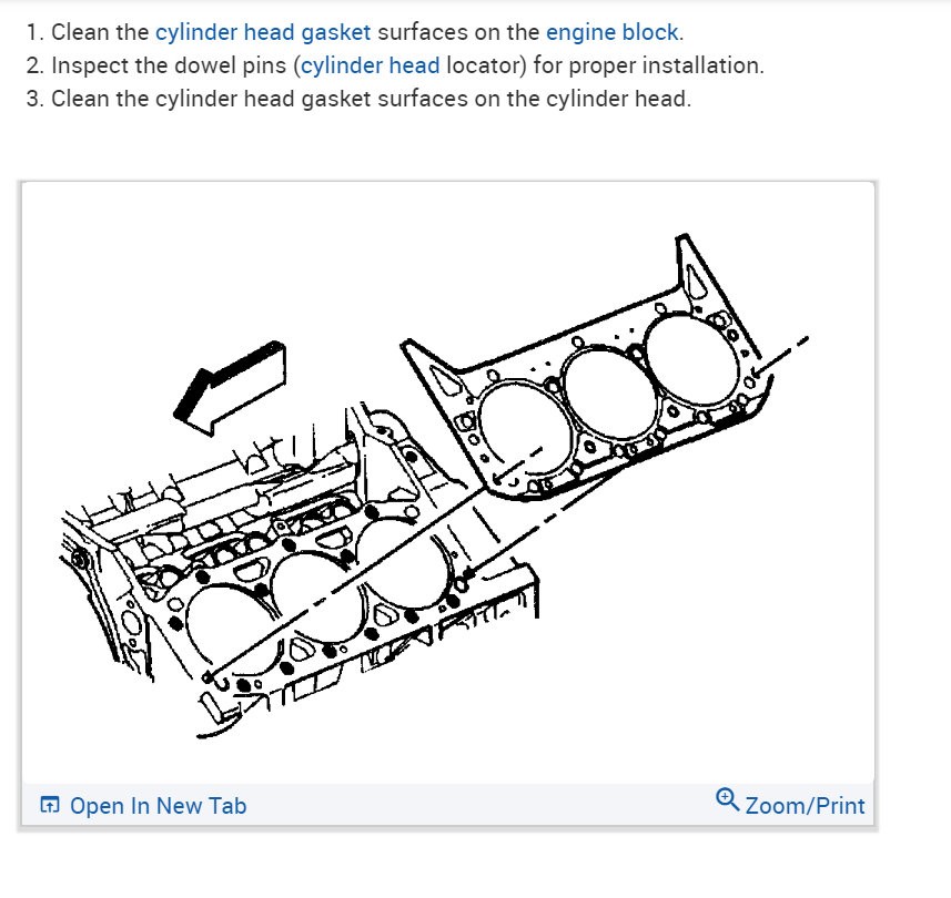

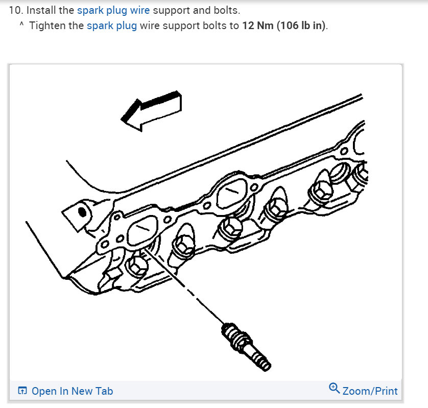

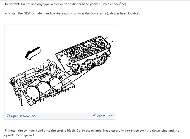

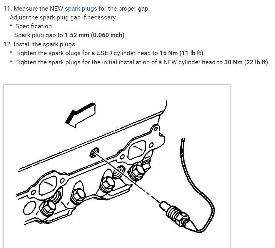

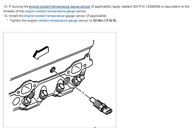

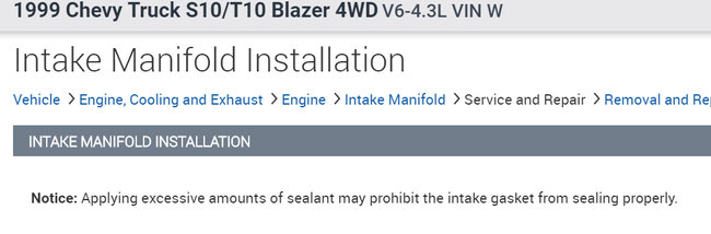

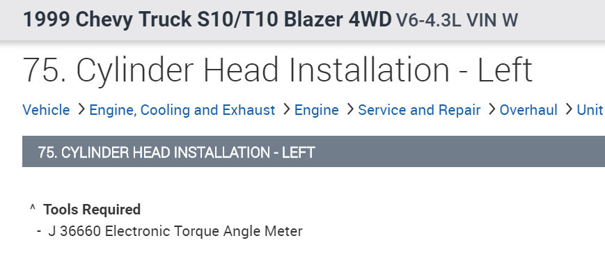

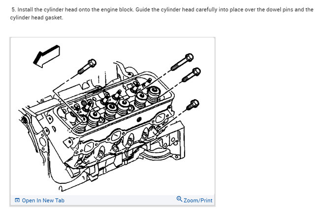

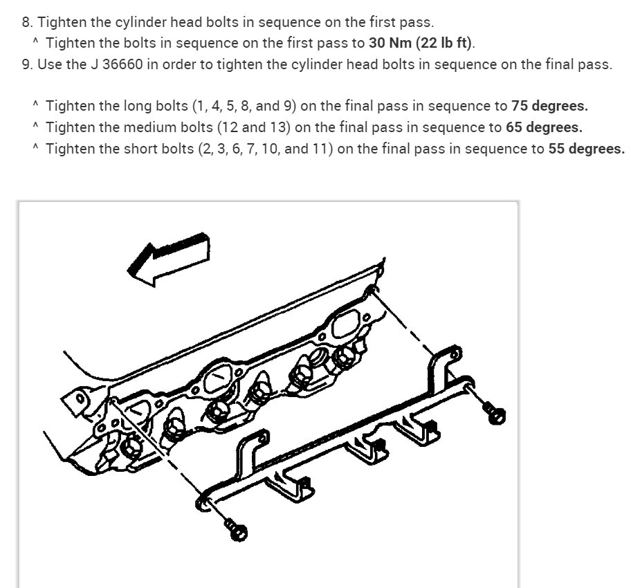

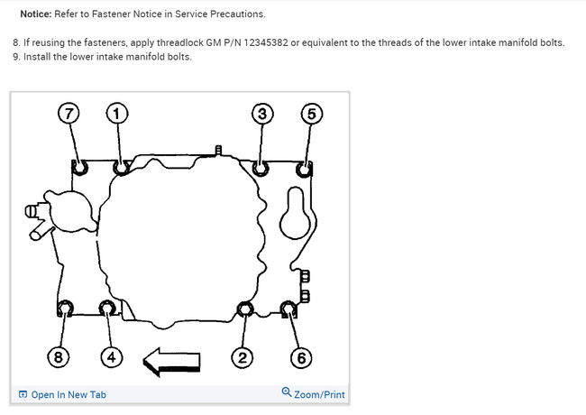

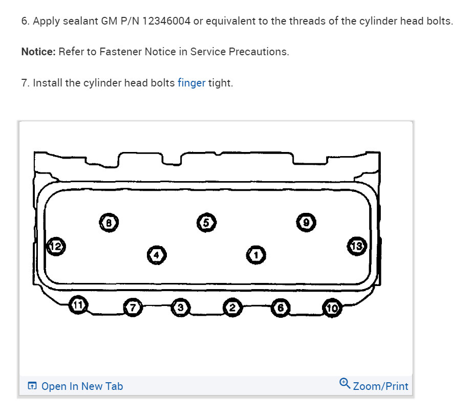

SCGRANTURISMO
  • 4,897 POSTS
Hello again,

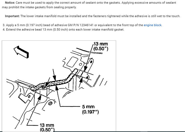

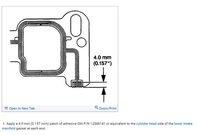

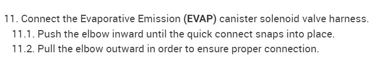

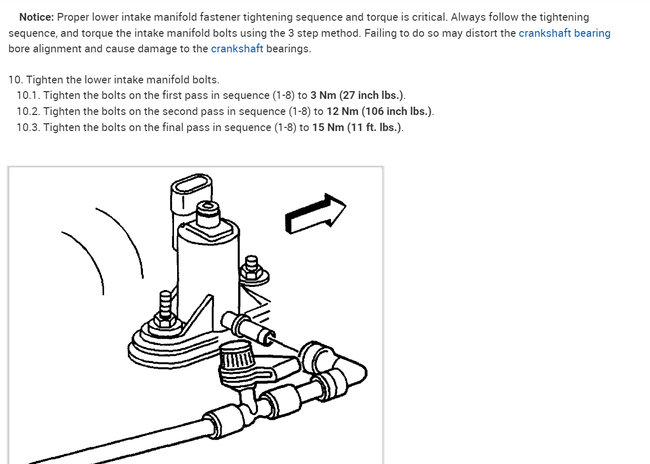

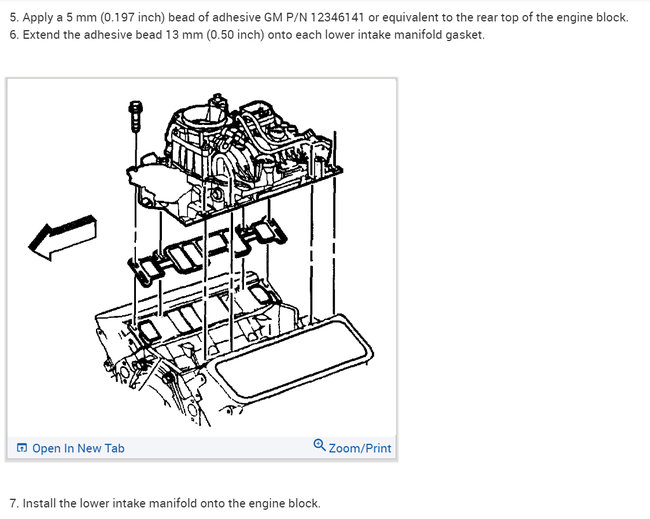

I have included installation instructions for both the cylinder head and the intake manifold for you in the diagrams below. Hope this helps and let us know if there any thing else we can do for you.
Thanks,
Alex
2CarPros
