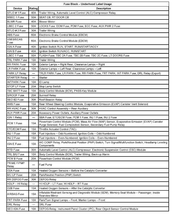

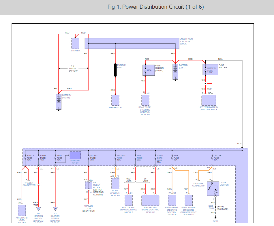

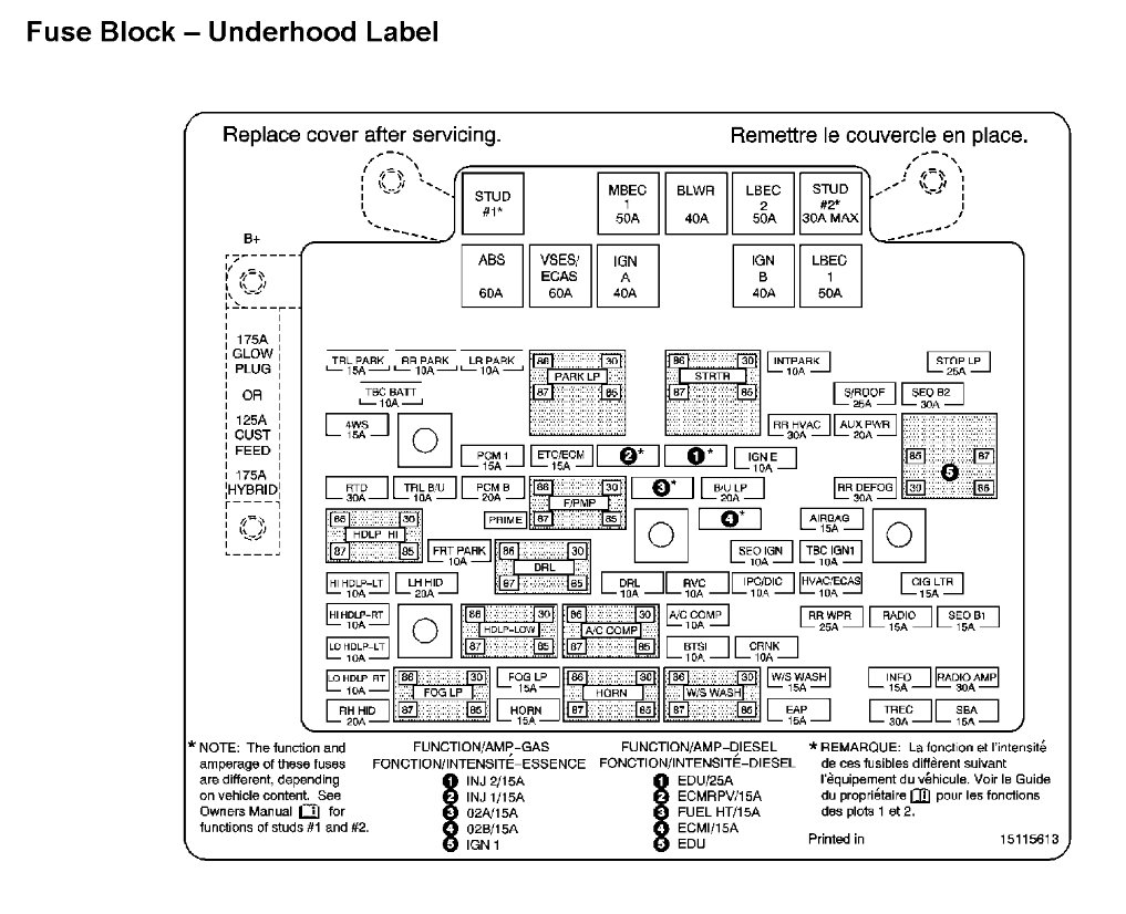

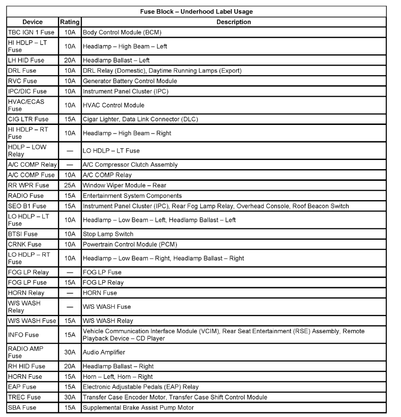

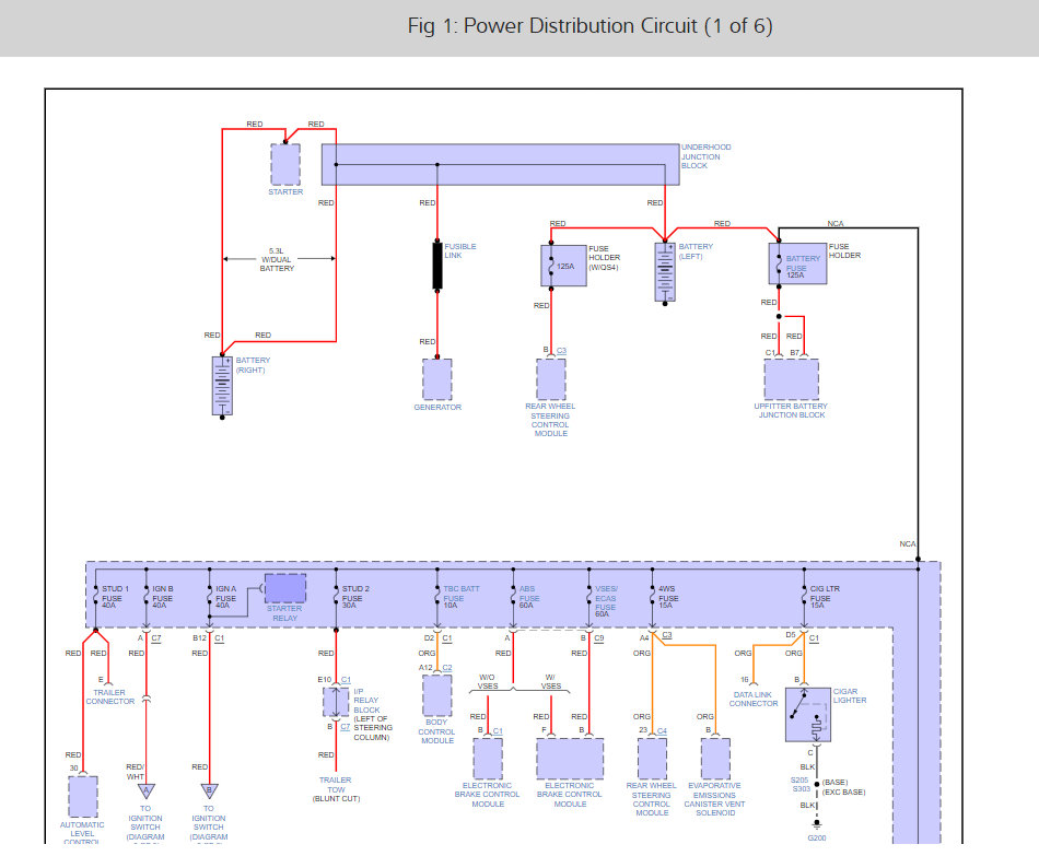

The battery is charged. I don’t know how to check if it's connected besides on the battery post. But Nothing, no clips, no sound of a want to, nothing. I really don’t understand. The only thing that was switched out was the radio. It’s 6 C-section radio went out. I replaced it with updated Bluetooth with rear view. I need a wiring diagram for that to double them. And I need to know where the battery is connected to the starter and what (if any) of the fuses I would need to replace. Please help ASAP.

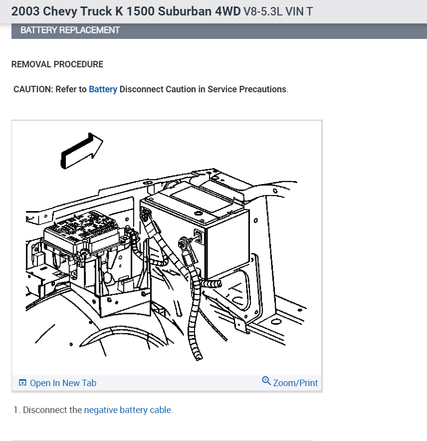

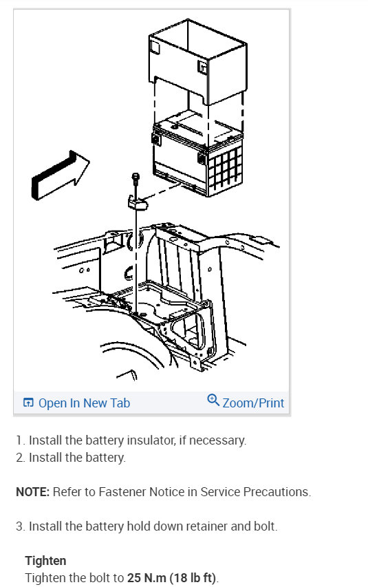

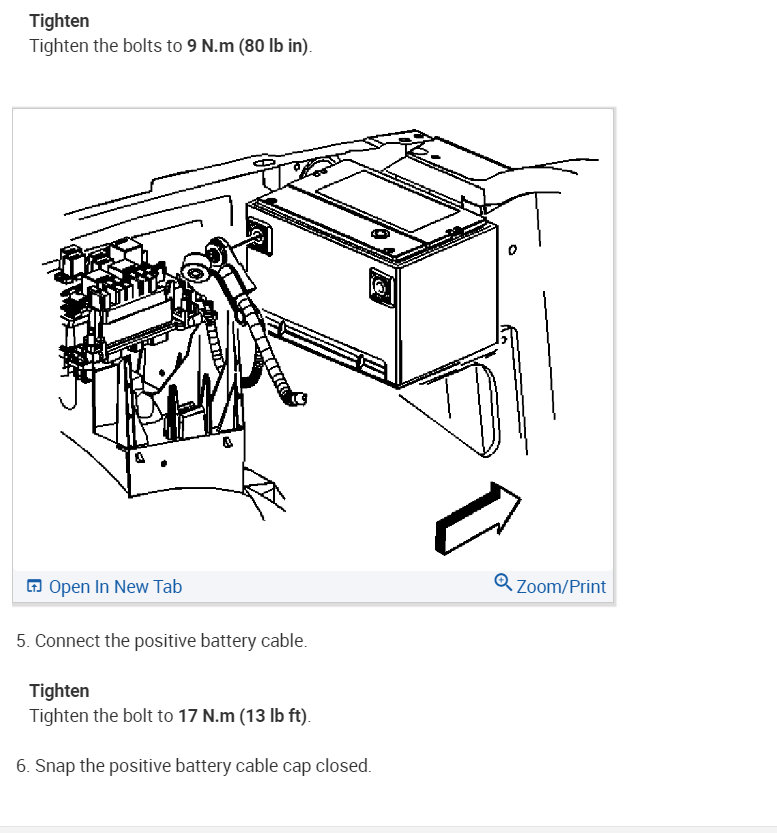

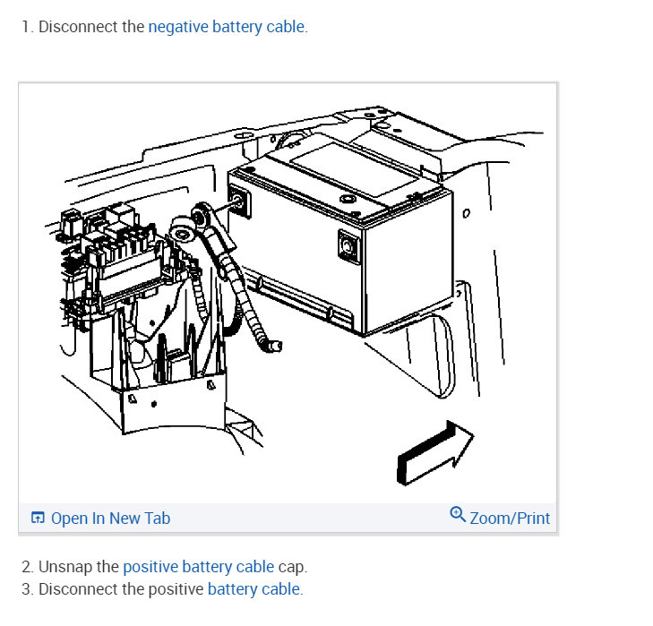

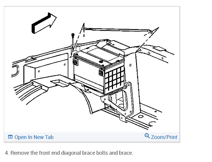

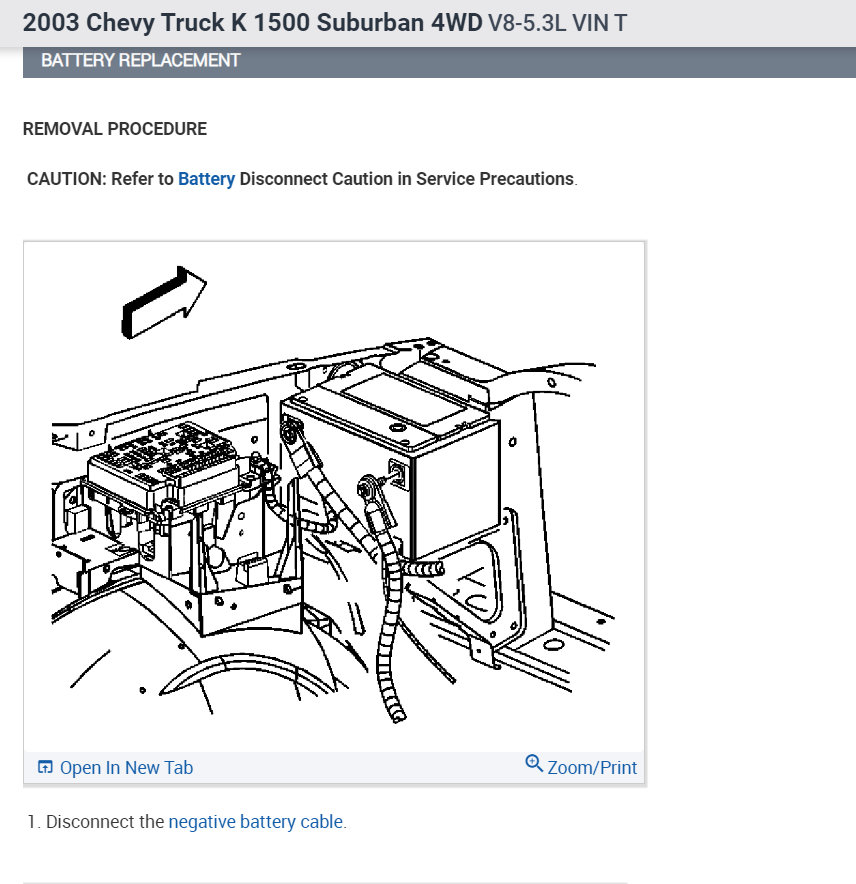

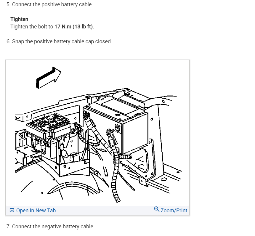

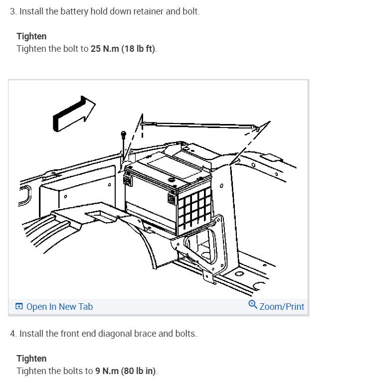

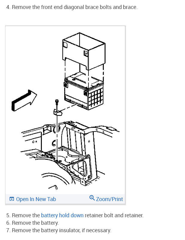

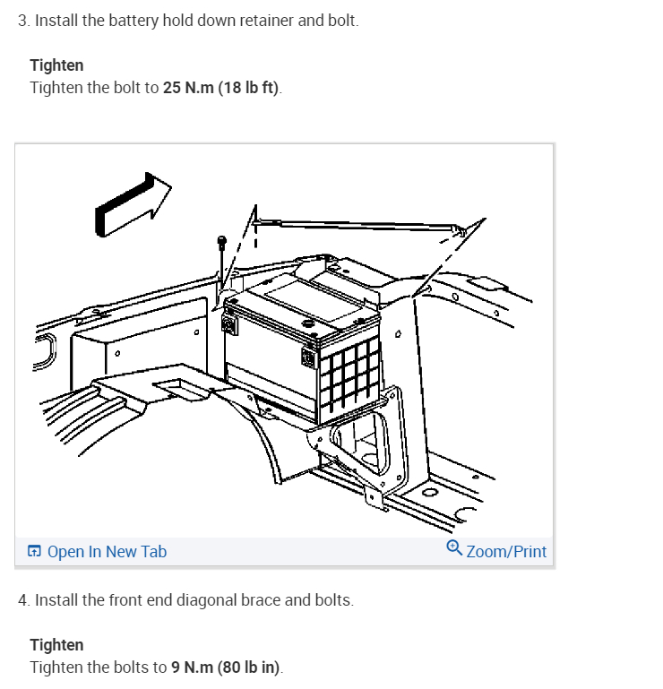

If the battery is not good, charging it will not help. I would clean the battery terminal ends and then see if the headlights come on. If not, let's try a new battery. Here is a guide to help us. Also, there are two large fuse holders 125 amp under the hood inside the under-hood fuse panel I would check.
Here is a wiring diagram that shows the main power feed for the car. Please wear gloves and protective eyewear when working with a battery.
https://www.2carpros.com/articles/how-to-replace-a-car-battery
