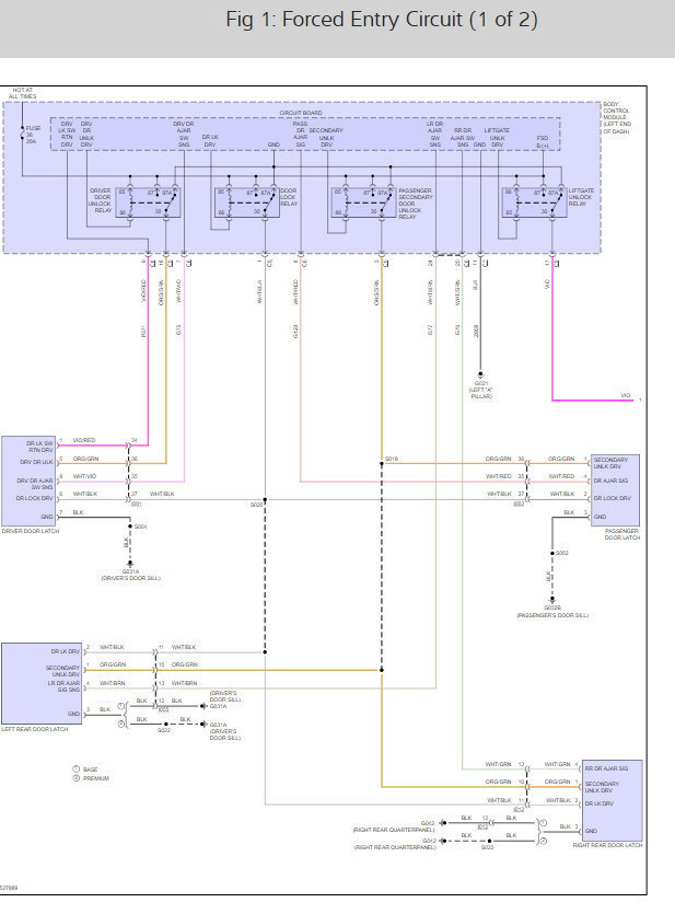

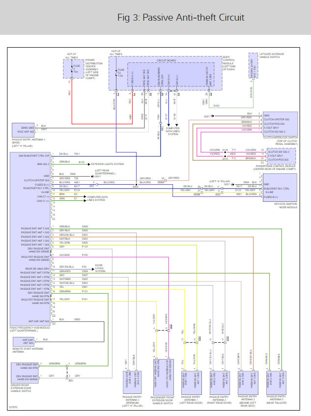

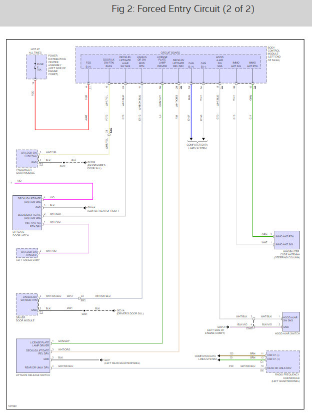

Press the button and brake. Car not recognizing keys and will not start.
May 25, 2018 at 6:06 PM
  • 55,711 POSTS

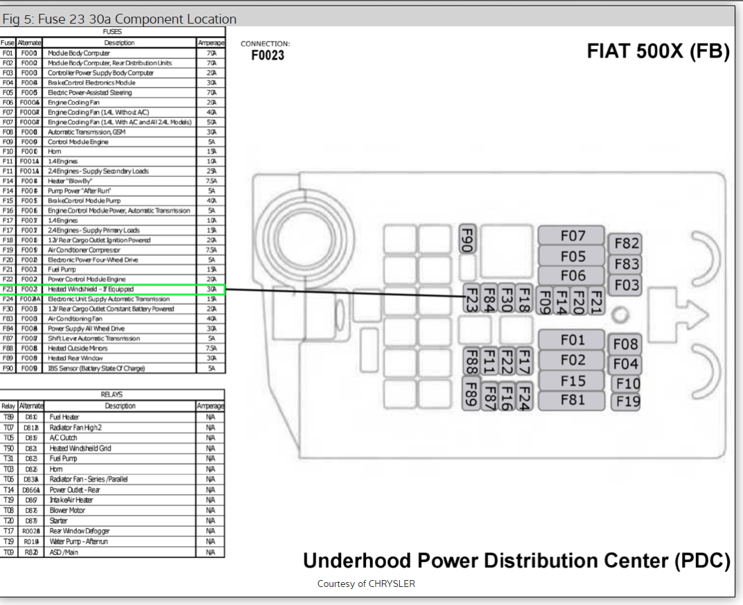

It sounds like the security system has lost its confirmation is the security light flashing? I would start by checking the fuses. Here is a guide and the fuse panel location and identification:
Here are the fuse panels and the security system wiring so you can see how the system works.
