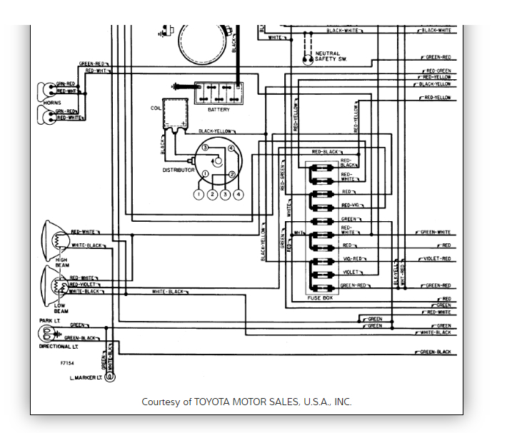

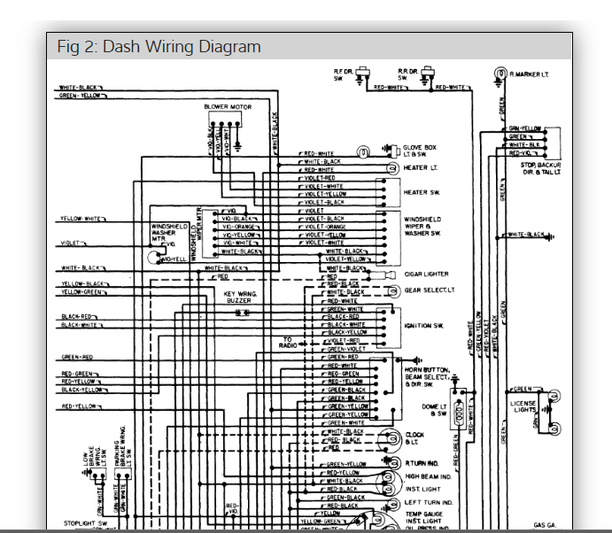

When I turn the key nothing happens.
Sep 21, 2019 at 2:11 PM
SCGRANTURISMO
  • 4,897 POSTS

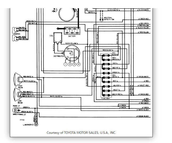

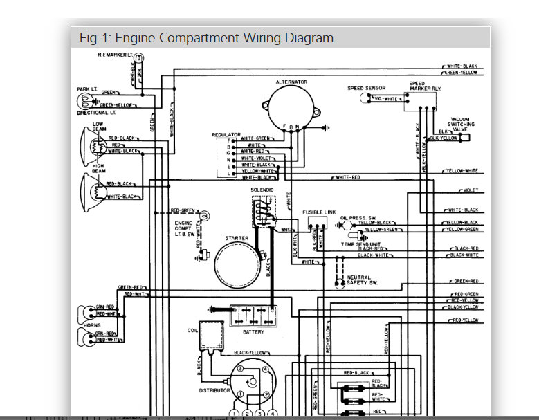

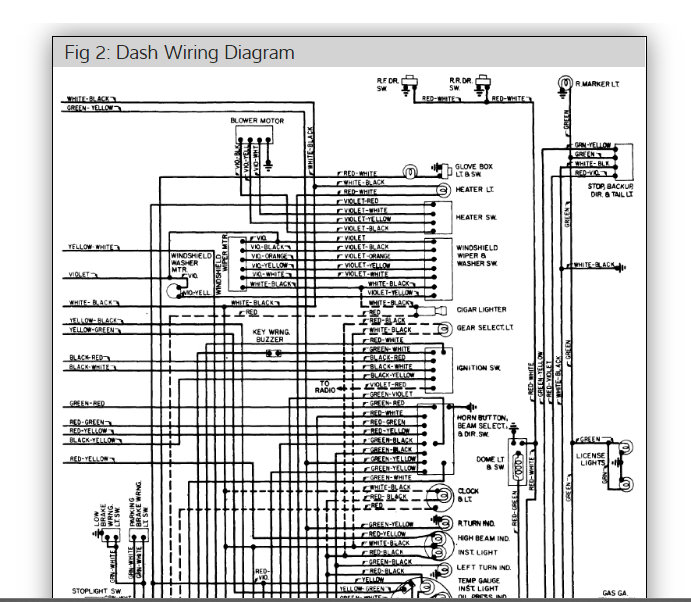

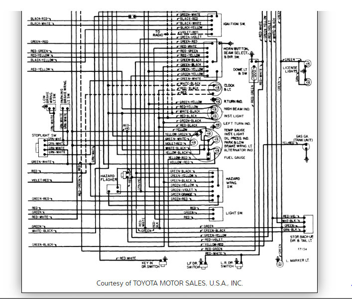

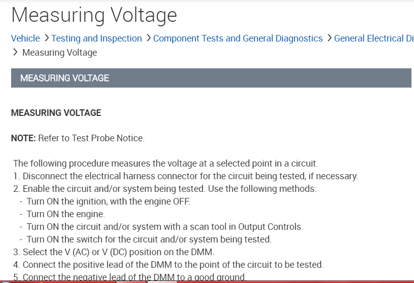

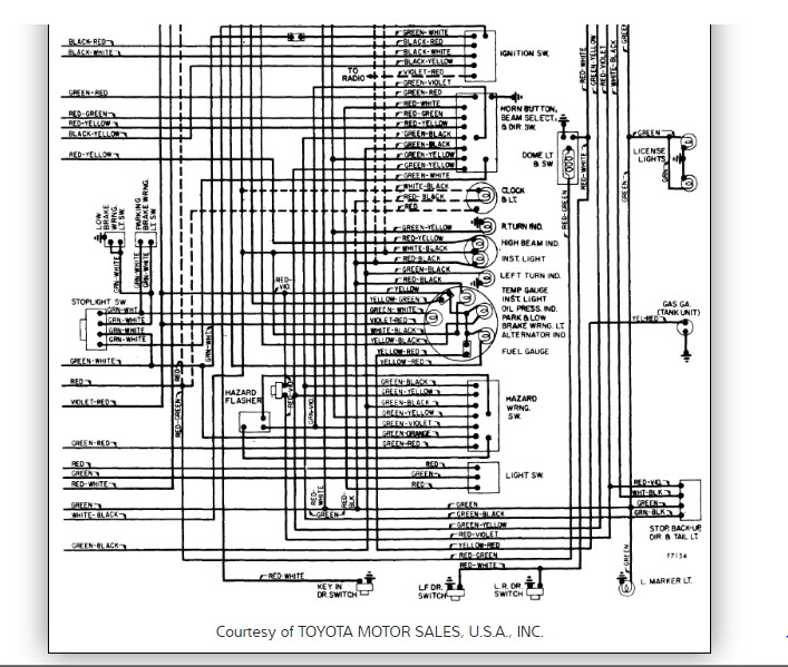

In the diagrams down below I have included the wiring diagrams for your vehicle. Please check and see with an assistant cranking the engine at the ignition switch can you take a voltage reading at the starter solenoid positive terminal. It should have a black/white wire going to it from the ignition switch. Here is a link below for you to go to if you are not familiar with how to use a Digital Multi-meter (DMM), if needed.
I have also included a guide on how to measure voltage in the diagrams down below as well. Please get this reading and report back with what you find out.
Thanks,
Alex
