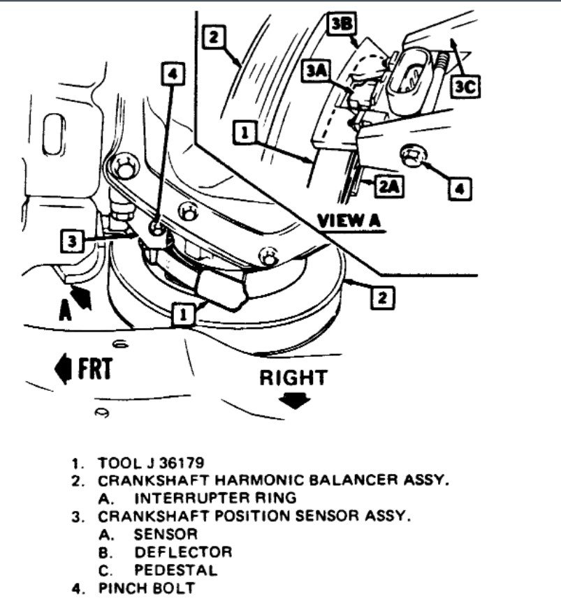

It quit running one. Always ran great. Well, I did some research. crank sensor, changed that and it fired right up. It ran great for two days, then did the exact same thing. replaced crank sensor again with AC Delco, but this time it didn't start.

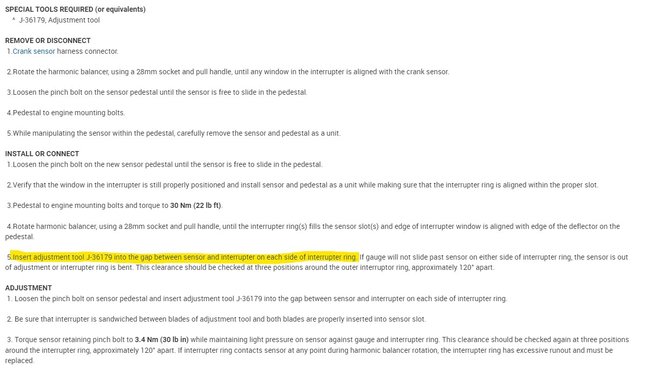

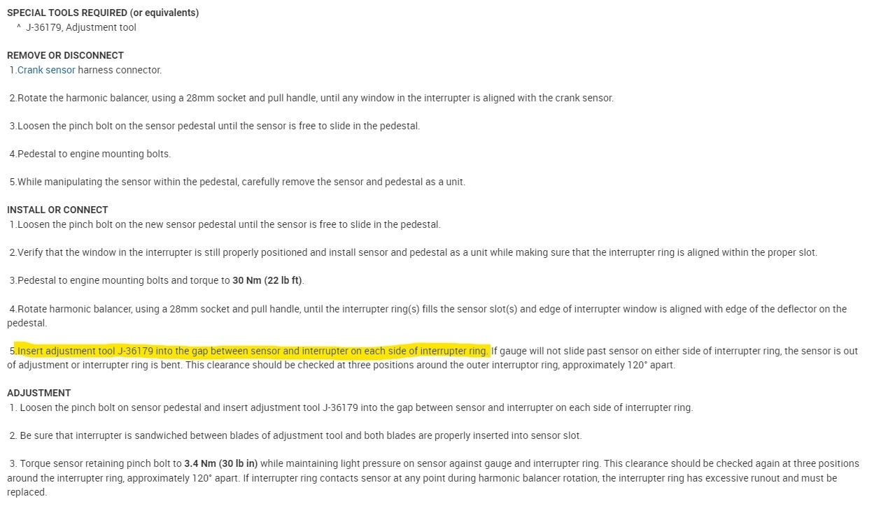

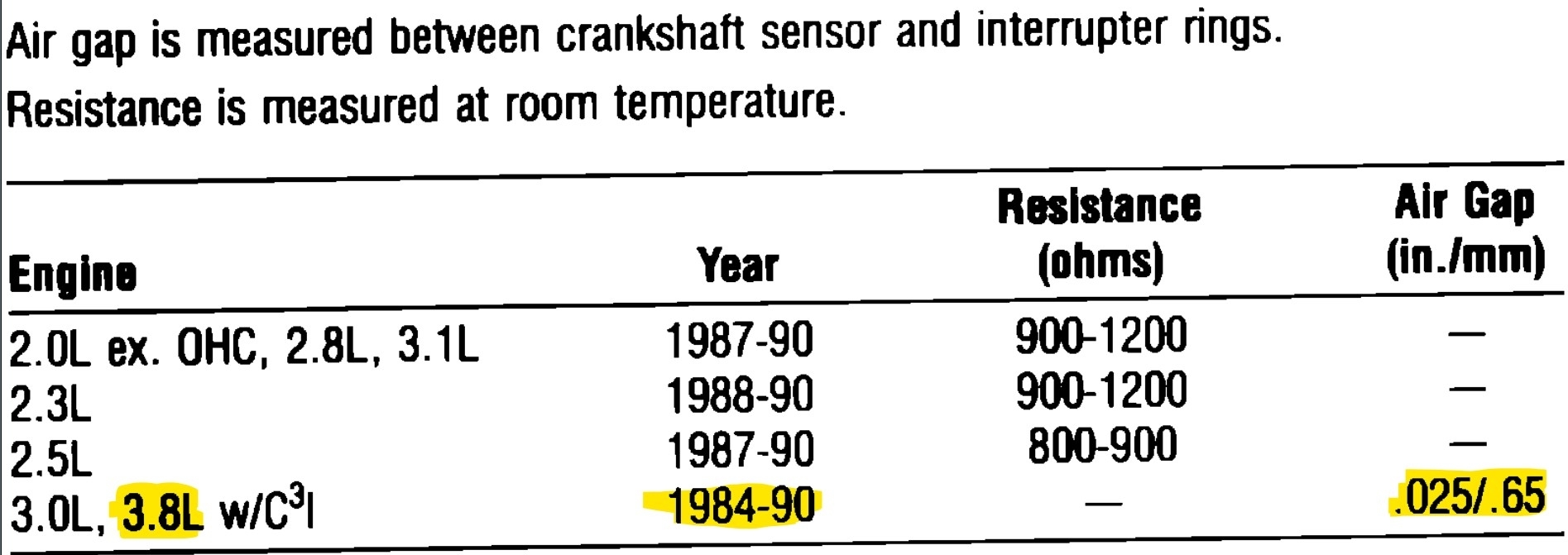

On this vehicle, the crankshaft sensor needs to be adjusted to maintain the proper air gap between the sensor and the interrupter ring. I've attached diagrams below to help with the process. You may also find this guide on replacing crankshaft sensors to be helpful:
