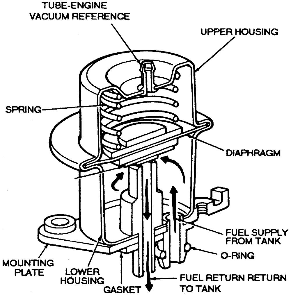

it should be the because I'm old the keyboard doesn't always co-operate with my fingers. it should be 45-60 psi with engine running and without running it should be50-60 but that doesn't test when you shutdown. TBI units look kind of like a carburetor check yoru crank sensor it should be 210-250 ohms its'in distributor in pic is proper way to test pressure regulator. if you are sure it's fuel it shold drop more than 5 psi in 60 seconds bu t that wil show you how to test it.

I came across an image before I received your reply (which I will try to attach here) which led me to believe that the problem could be a weak spring in the regulator which would explain the loss of pressure after the engine (and fuel pump) have stopped. this would explain why it would take so long for the gas to reach the injectors.

it is probably the only valve in system other than one in pump maybe. that test is to scheck pump and regulator.

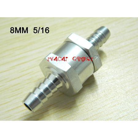

Oct 15/2014,
Thanks again for the input.
The comment you made;
"It is probably the only valve in system other than one in pump maybe. That test is to scheck pump and regulator."
I don't think is correct,
I think the problem is probably with the valve inside the pump.
I know the pump only has 20,000 km on it, so I'm probably going to live with the inconvenience of cranking it 2 or 3 times to get it started.
Once started, it runs fine.
I was thinking of putting in an inline fuel check valve.
I phoned local auto stores; they don’t sell.
I looked online and found some (see picture), but they don’t specify a pressure rating which I would like to see.
My only concern about doing this would be that I may be creating an air pocket between where the check valve is installed and the tank’s pump.
What are your thoughts?
A) Where can I get a check valve for fuel?
B) Air pocket concern?
Thanks again,
Chris
Oct 15, 2014 at 5:11 AM
HMAC300
  • 48,601 POSTS
it's not worth the money or time to put that in your system,it's more trouble than it's worth. I can't answer any more due to being away from home computer and won''t be back until end of month . probably what is really wrong is car is old and pump is weak causing this and just put up with it until it fails completely. if you aren't satisfied with this answer then repost and another mechanic will answer
