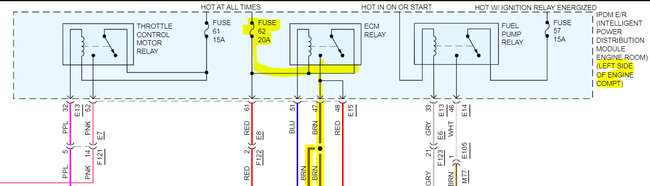

I checked my spark plug and there was no spark. So, I changed the crank sensor and still no go. What else can it be?
Oct 24, 2022 at 8:41 PM
  • 110,194 POSTS
Have you checked fuse 62 in the fuse box under the hood? If not, do that first. In addition to checking the fuse, confirm there is power to and from it. (See pic 1 below)
If the fuse is good, I need you to check the ECM relay in the same location. If there is a different relay with the same part number, switch them. If there isn't, here is a link that explains how to test a relay:

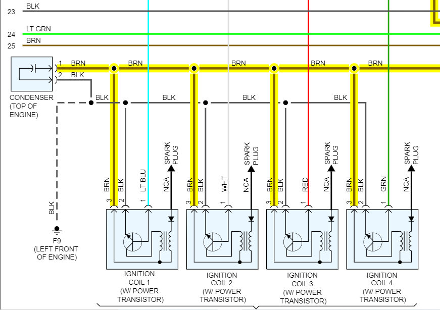

If that checks good, go to any of the ignition coils and disconnect the connector. Each coil has a brown wire going to it. Check to see if there is B+ voltage to the brown wire. (See pic 2)
Let me know what you find.
