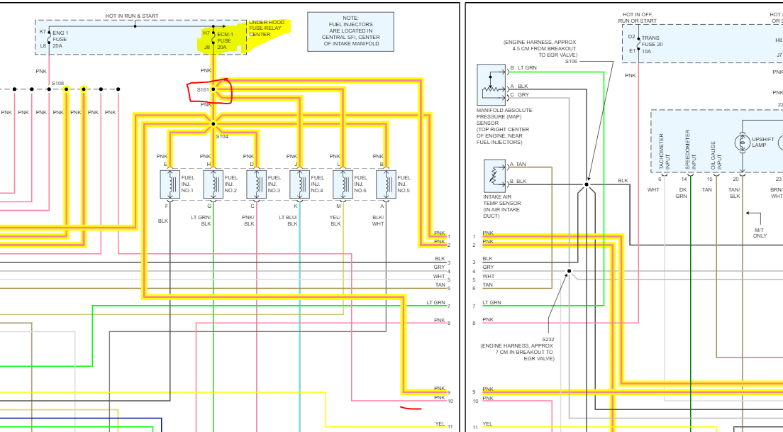

I attached a pic below of where the power supply starts for the ignition coil. Check the fuse first.
If the fuse is good and has power, the next concern is the large splice where multiple wires come together. We may have an issue at that point.
Let me know what you find.

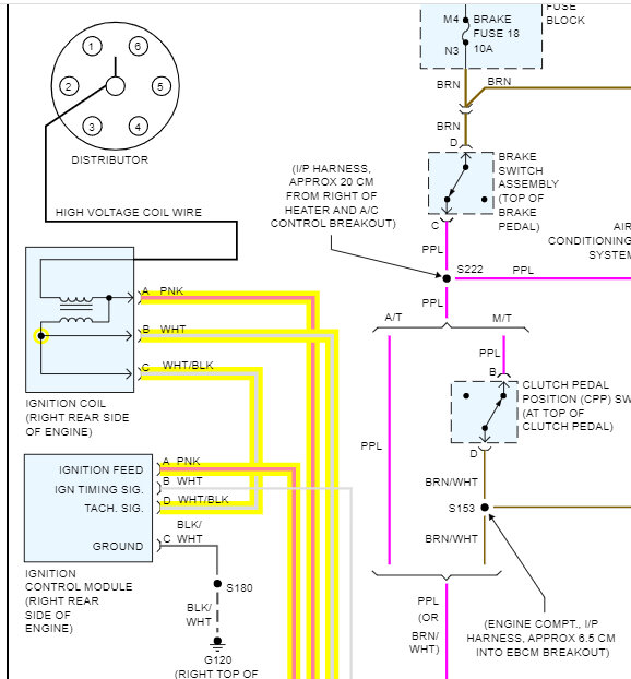

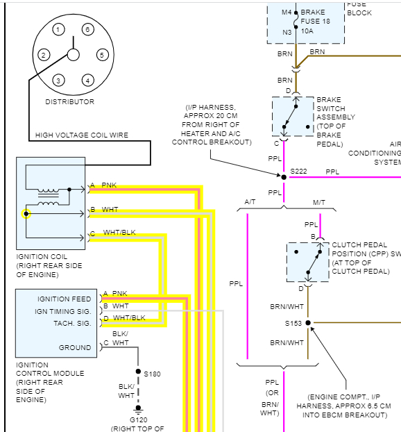

There should be 3 wires. The pink is the power supply as you know. The solid white wire sends a tachometer signal to the tach in the vehicle. The black wire with a white tracer goes between the coil and ICM and provides a tach signal. See pic below.
Let me know if this helps.
Apr 2, 2023 at 11:03 AM
