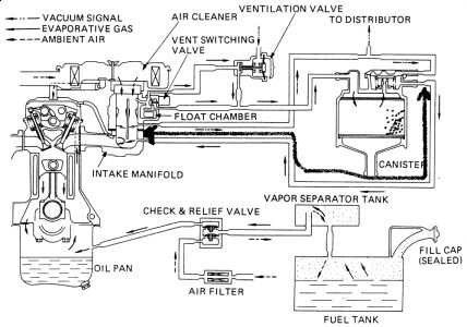

Upon inspecting my engine, I've noticed that all my hoses on the Vacuum canister are not connected. There are 4 spots for hoses. 3 on top, 1 on bottom. The top three are connected as they are supposed to be. However, I cannot, for the life of me, find where the bottom hose is supposed to go. It was completely missing, so I bought another hose in hopes I could find the spot it was supposed to go. However, I have had no luck. Could you please tell me where this hose needs to go? The port on the bottom sucks in, as I've noticed by putting my finger against it and playing with the throttle.
I don't know if this problem is tied in to my other problem. The vehicle jumps when in the high revolutions of the engine. It doesn't do it all the time, and it seems if I press the throttle in all the way, it won't do it. I don't know if the hose is the source of this problem or not, I'm just trying to give you some background so you'll have a better idea of what I'm looking at.
I'm not too proficient with vehicles, but I can do what I need to as long as I'm pointed in the right direction. Thank you very much.

Hello MetalMoses18 Welcome to 2carpros and merry Christmas The bottom hose is supposed to go from the canister to the intake manifold. Because of vacuum leak the vehicle jumps as you said. Connecting the hoses right should take care of the problem. Use this diagram to help you connect it back.

If you look at the diagram, and look at the canister, you'll see the cone part on the bottom. Your arrow runs right by there. Is that supposed to be open to the air or should there be a hose running somewhere? As it stand right now, it's open to the air. There is no hose attached to it, and I can feel the air flow from it. So should there be a hose attached or does it just sit like that? Thank you.

Yes it should be like that.Nothing should be connected below there ,its job is to suck inn air.

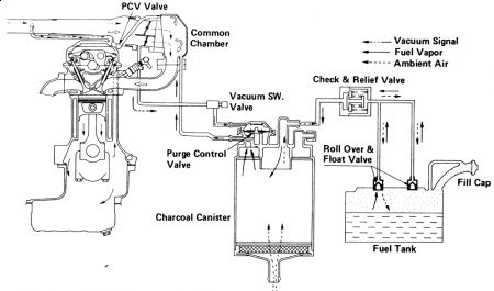

Before testing the fuel pump, I would like to do a test on the charcoal canister to make sure it is working. 1988-95 MODELS 2.3 L See Figure 3
https://images.2carpros.com/forum/automotive_pictures/46384_2_5.jpg
1. Inspect the canister for cracks or damage. Also check for leaking fuel from the canister. 2. With the engine OFF , disconnect the common chamber side hose (A) and blow air into it. The hose should be free from restrictions and the air should flow into the canister. 3. Reconnect the common chamber side hose to the charcoal canister. 4. While the engine is running at idle, disconnect the rubber vacuum hose (C) from the charcoal canister. Use a vacuum gauge to ensure that no vacuum is being applied to vents (B) and (D). If vacuum is exhibited at these ports, or if the common chamber side hose circuit is restricted, the charcoal canister must be replaced. as I said before, the following figure shows that the hose below should be free for ambient air:
https://images.2carpros.com/forum/automotive_pictures/46384_0900c15280061f96_1.jpg
Do the test on the charcoal canister,if there is no problem with it, I will help for the fuel pressure.
