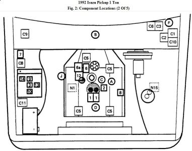

My 1992 isuzu truck would at times start fine and at times would turn over but would not start . i left it sit idriveway 6 months + and now wont start at all . after checking a few thing s i found out im not getting voltage to my fuel injecters when i i turn motor over , so what would cause this ?i have already replaced the computer. Its a TBI Fuel injection unit.

At the injector there are 2 wires, 1 for each injector that receives power supply from the ECM relay. From ECM relay wire color is Light Green/Black and at injector it is branched into Light Green/Black and black/Blue. Test the ECM relay and its power supply. since problem is intermittent, I would suspect the relay or its circuit to be faulty. Item # 9 is the ECM relay.
https://images.2carpros.com/forum/automotive_pictures/192750_CompEng92Isuzu6cyl_1.jpg
