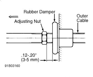

I can't figure out how to change out my clutch cable, can you help with instructions
Jan 23, 2010 at 7:15 AM
DOCFIXIT
  • 18,828 POSTS
Hi Loosen adjusting nut then clip holding cable to bulkhead.

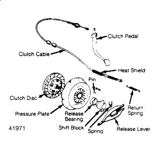

Raise vehicle remover return spring remove cable from fork. next remove cable from clutch pedal. Then pull cable into engine compartment and up from trans.
