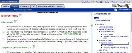

I need to time my truck it is way off when I go to start it it cranks then pops realy loud and won't start

Set it at 12deg BTDC and also see below
https://images.2carpros.com/forum/automotive_pictures/12900_timing_30.jpg
